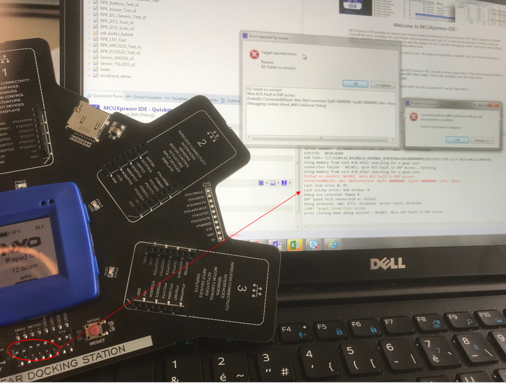

     I am working with Rapid IoT currently. The board was working fine when I download the bin files through rapid Iot studio online [https://rapid-iot-studio.nxp.com/ ]. I searched through examples in the community to flash a program using MCU xpresso into rapid iot board using hexiwear docking station.  I found this demo RapidIoT: Led Matrix Easy & Quick start demo
   I modified the code a bit to add my functionality. It was working fine. I was able to debug the code and visualize it in console.
  The I tried to flash "hello world" the demo example from rapid iot k64F SDK using the docking station and rapid iot board placed in it . But the debug of "hello world" was not working and it was debugging this previous demo RapidIoT: Led Matrix Easy & Quick start demo
  The leds near SW1 in rapid Iot board was glowing blue and white color.
  I tried all the reset methods which was there in documentation. But nothing helped. It keeps on debugging the same demo over and over whenever I try.
Please note that jumper pins are set for K64F board in docking station -  11001000.
  I am not sure why this is happening. The rapid Iot seems to be stable when i use studio IDE to flash the code  but not MCUxpresso. Why is this happening ? I am not able to understand. This is the second time I am facing this issue. Last time my rapid Iot board crashed when I tried to work with MCU xpresso and it never booted again.

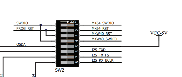

Hi both,
The symptoms you describe again point to a K64 booting issue, likely cause the bootloader has been overwritten.
K64 is not booting and certainly maintaining the PROG_RST reset pin to 0.
This pin is also connected to MK20F reset as can be seen on the docking station schematic:
https://download.mikroe.com/documents/specials/hexiwear/Hexiwear-docking-station-schematic-v102.pdf
As a consequence the docking station is always booting in maintenance when the kit is plugged in and the switches are set to 1100xxxx.
You can try booting your docking without Rapid IoT and you will see it will boot normaly.

     I followed your instructions:
1. Without rapid Iot board, I switched on docking station. It showed IOT-DAPLINK
2. I turned it off and plugged in Rapid-IoT board
3.I changed the MK20F pins to 00111111 and turned On the docking station
4.It is still showing MAINTENANCE  mode.
I checked my device manager when it is in Maintenance mode and I could see the device under USB  controller as mbed composite device but nothing in portable devices.
I should be able to see the device under portable devices for dumping the Kboot K64F into board through MCU Xpresso.
I could see
1. Docking station works fine. Cause i tested with other rapid Iot boards
2. "USB  controller as mbed composite device" rapid iot board with docking station is getting detected .
But I cant understand why it is not changing to IOU-DAPLINK still?

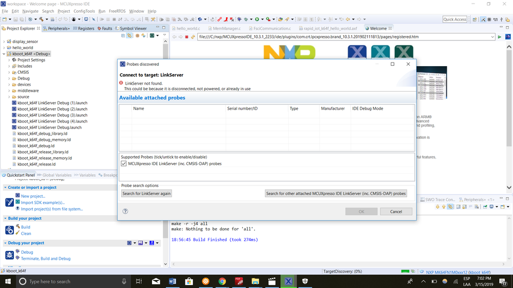

alejandro_abrah
Hi Eric,
Thank you for your feedback.
I did the first part and obtained:
Then I built and tried debugging as per your video instructions:
After that screen it did show the Connect to target: LinkServer with one available attached probe. I clicked Ok, and I got the following:
And I still cannot upload the bootloader. What do you think it can be ?

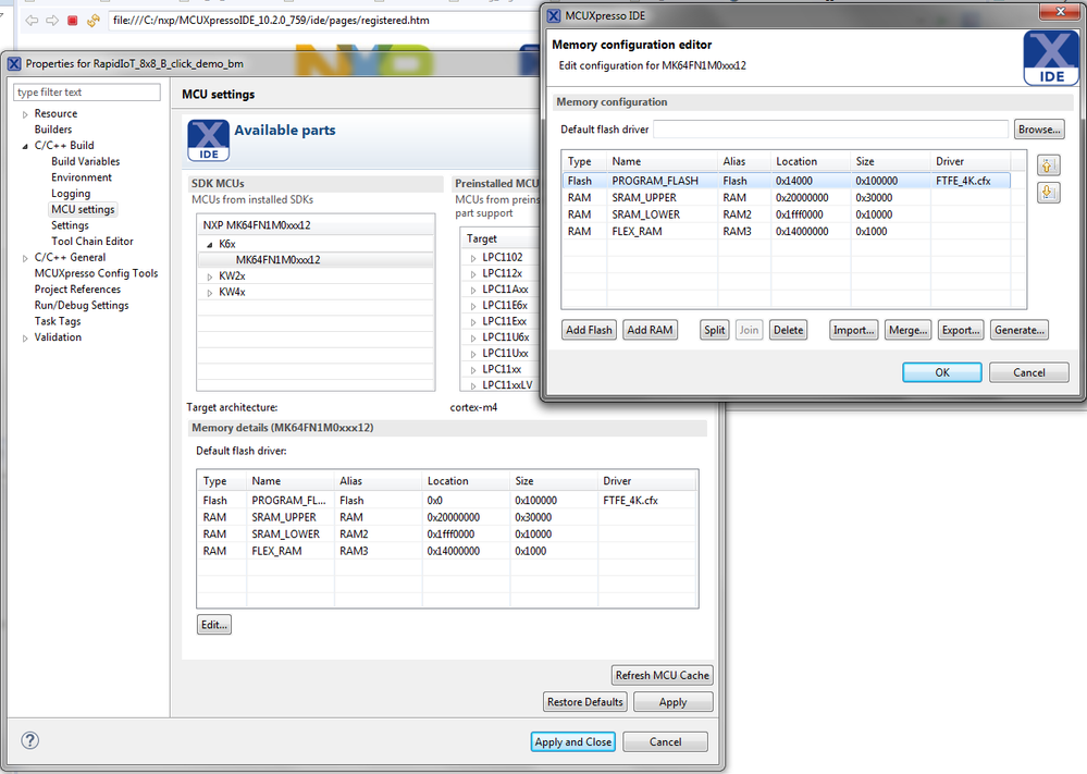

The problem you are facing is likely a typical one many users are facing. The white and blue led indicates the kit is not booting (actually KW41Z is not booting).
Few détails: as we have 2 µC in the kit we need to manage their respective resets as they will exchange information. Out of factory, this is managed by boot loaders flased in both KW41 and K64 from address 0 onwards.
Then for K64 the bin you would flash on top must start at address 0x14000.
I just checked and it is not the case for the example project from Jean-François. I will get this fix so later users do not fall in same trap
When writing code from MCUXpresso, this can be configured in the project properties - here is where it needs to be changed
In order to recover, you would have to reflash kboot for K64F.

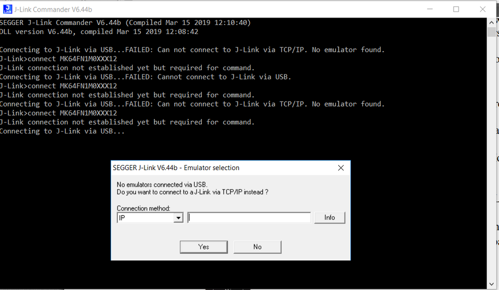

alejandro_abrah
In addition, I followed the Rapid IoT User's Guide at page 114, and I tried to use JLink Software package, but it looks like it does not recognize the docking station. Still the rapid IoT board shows Maintenance drive:
Thanks !
