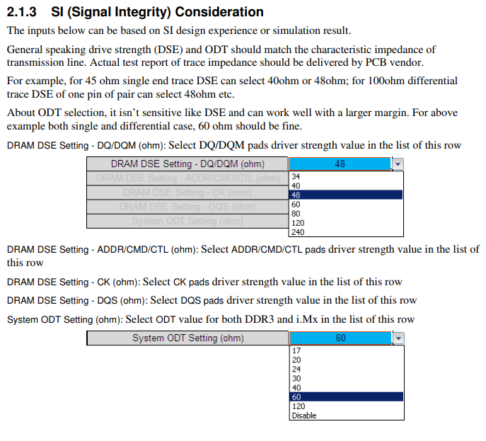

Hi All,
I have done DDR memory calibration for my imx6q custom hardware design using NXP stress tester version 2.9 in ambient temperature and got proper and reliable read,write,dqs gating values for DDR memory. And I updated u-boot configs according to those values as follows.
Design passed all memory tests.
Memory AS4C256M16D3A-12BCN
System was running properly on the day I calibrated and after few days I'm getting kernel panics.
As well as I have 50 units of this units some units work properly and some are getting kernel panics.
  1. Any dependency on memory calibration on humidity or moisture ?
  2. Can you see any fault in my configuration file ?
Peter.

One can tweak signal integrity, described in sect.2.1.3 SI (Signal Integrity) document below

one can try to tweak drive strength, it can be changed both for i.mx and memory.
Also may be useful to tect with linux memory tester, it also stresses power supplies.
igor

Are the Drive Strength change and Signal integrity are same ?
I do signal integrity changes as follow.
Do we have any other way to change drive strength and signal integrity in uboot level ?
1,724 Views
igorpadykov
Hi Peter
please check presentation IO Buffer Modeling Considerations for High Speed Buses:
https://www.nxp.com/files-static/training_pdf/VFTF09_AN112.pdf
no
igor
1,724 Views
