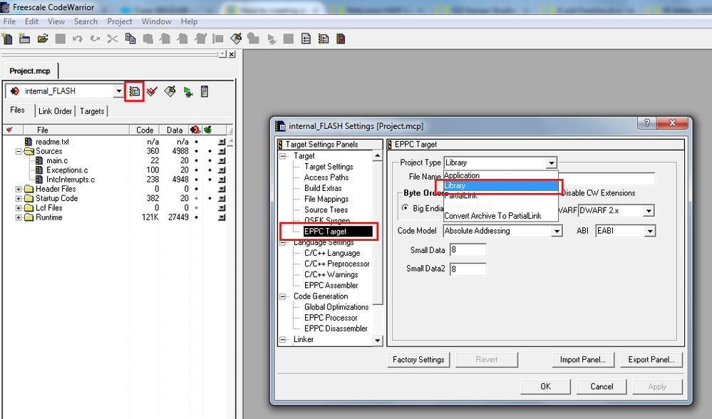

After a few days of research, and did not find static library related options in CW for MPC55xx.

it is possible to create static library using CW for MPC55xx, MPC56xx 2.10. Create new project, open project settings and click EPPC Target. On the top of this page, there a menu which allows you to choose Library. Please see the figure below:
If you have any other questions, please feel free to write me back.
