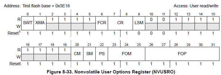

1 - The MPC5675K came from factory in DPM mode, it means that bit 9 (LSM) on NVUSRO is not set, as stated here:
S2 1420_3E10FFFFFFFFFFFFFFFFFFBFFFFFFFFFFFFFCD

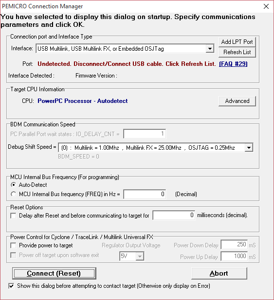

3 - Install and run progppcnexus.exe and ensure MCU is powered and Multilink Connected (I´m using FX), choose the right Interface and press Connect(Reset);

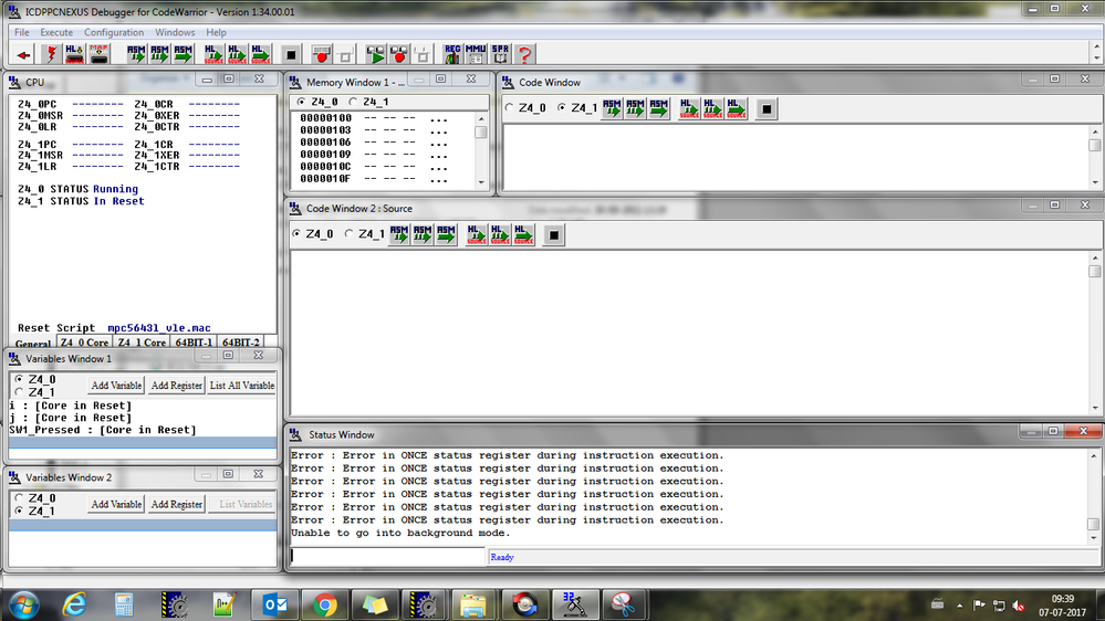

   I am currently working with Development board KT33908MB with KTMPC5643DB (mother board and daughter board). I am trying to create a base code to switch on the led's on the mother board , operating the controller in LSM and DPM mode. I used "CW for MPC55xx and MPC56xx 2.10" to generate a code for DPM and LSM separately. In the DPM project, i configured the ports and wrote a simple code to toggle the led.
Now when i established the connection to the daughter board (PE Multi-link Universal JTAG and icdppcnexeus) i could see the message, "Processor detected in lockstep mode". I followed all the steps mentioned in these posts to change between LSM and DPM mode.
      1. Used progppcnexus to upload the s-record file and modified the value at addr 0xFFFE10(modified.s19). Erased the module, programmed it with the new s19 file, verified and Powered down the board. (script - Freescale_MPC5643L_1x32x4k_Shadow_Blk_Freescale_C90FL_Driver_031.PCP)
      2. Now used the icdppcnexus to connect to the board. Again got the same message, "Processor detected in lockstep mode"(pic 1). And when i loaded the object file of my DPM project (RAM.elf), and gave GO, i got the below response(pic 2) (script : mpc5643l_vle.mac)

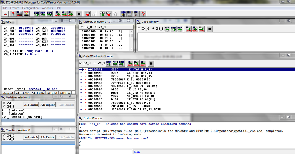

      3. When i programmed the already existing s19(attached here) and then flashed my code, the code worked as expected. It checked for a switch press and toggled the pin on switch press.(pic 3)

pic1:
pic 2:
pic 3:

It is assumed the LSM mode is selected within a shadow flash, see Nonvolatile User Options Register (NVUSRO) within a Reference Manual.

The LSM or DPM mode is selected within a shadow flash, see Nonvolatile User Options Register (NVUSRO) within a Reference Manual.
Sean's MCU was programmed for DPM (NVUSRO = 0xFFBFFFFF, indicating that DPM is still set).

2) Address to be changed is at 0x0020_3E18, with bit 0x0040_0000 set for LSM and cleared for DPM.  My S19 record file changes from:
     S214203E10FFFFFFFFFFFFFFFFFFBFFFFFFFFFFFFFCD
     to
     S214203E10FFFFFFFFFFFFFFFFFFFFFFFFFFFFFFFF8D
Otherwise, the steps in the PDF are as specified.
