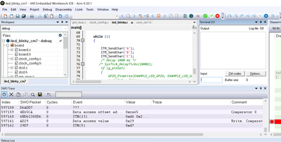

  Today, I downloaded a new JLINK driver, and test it again, I find SWO have the log in IAR:
But, the terminal no data for the ITM_Sendchar, I will check with IAR side, whether there has any point need to note.
Kerry

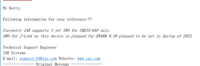

   RT1170 is a little special, it is related to the ERR050708.

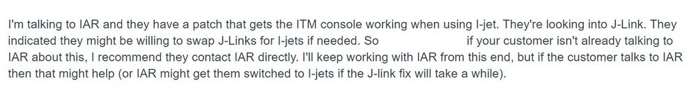

  So, to the IAR, I have checked with the IAR side previously:
So, you need to check your IAR version is matched, if meets any issues in IAR, you also can contact with IAR side, as they already test it.

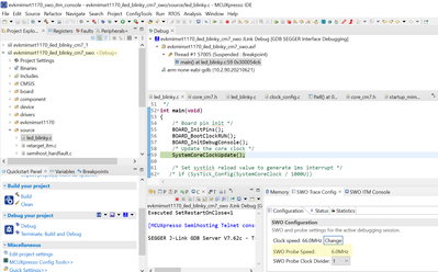

But, to the MCUXPresso IDE, I make it works previoulsy:
 I use the configuration on the RT1170 MCUXPresso IDE with MCULINK pro cmsis dap debugger, it works OK.
This is the test result:
Here, you just need to use the IAR+RT1170+JLINK+SWO, right? Not the MCUXpresso, right?
Please confirm it, as I don't have the directly Segger JLINK on my side, I will use the MCU-LINK pro with JLINK firmware to test the SWO in the IAR.
Please also update your IAR version to:
IAR Embedded Workbench for Arm, version is 9.30.1
Kerry

 Your side, please also upgrade the IAR version, as I can make sure your version can't let the RT1170 SWO works, it is confirmed by the IAR side.

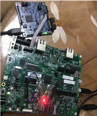

  Share you my MIMXRT1170-EVK rev C1+ MCULINK pro(jlink firmware) test result.
  Please note, when use the external JLINK, you need to remove J5,J6,J7,J8.
  My connection like this:

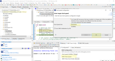

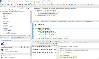

Please use my attached project again, this is tested just today with MCUXpresso+JLINK
This is the related debug steps:
1, enter the JLINK debugger
Here, you can see, the SWO clock still not recoginized, as the code still note configure it.

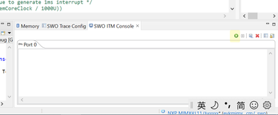

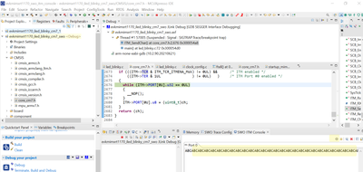

Set the breakpoint like this:
Then, wait a moment:
You can find SWO clock is recognized, then you can test it:
Start:
You can find the SWO ITM console have the data.
Please try it on your side, at least make this one works.

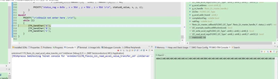

Here I tested on MCUXpresso as you suggested, yet the output doesn't go on "SWO ITM Console" but regular "Console" and is not what is expected (garbage data).
Regards.

kerryzhou
Hi @dkoch ,
   As I know, it is related to your debugger.
   I am using the MCU LINK pro with the JLINK firmware, it works perfectly.
   I share my test video.
You can see, it all outputs to the SWO ITM Console.
So, mcuxpresso IDE works OK on my side.
To the IAR+SWO, I can confirm it really has issues, and IAR side also didn't give me any valuable reply, they also check with their internal side. If you really need the IAR as IDE, I highly recommend you also contact with IAR side, it is really related to the IDE, thanks.
