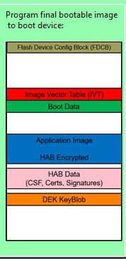

Because we need to use the HAB encrypated boot mode, then we will use MXRT105X-SecureBoot, from the ucl2.xml file, we will find the following related code:
Fig 1. MXRT1050-SecureBoot structure
As you can see from the above, to implement the secure boot of RT1050, you need to prepare these three files:

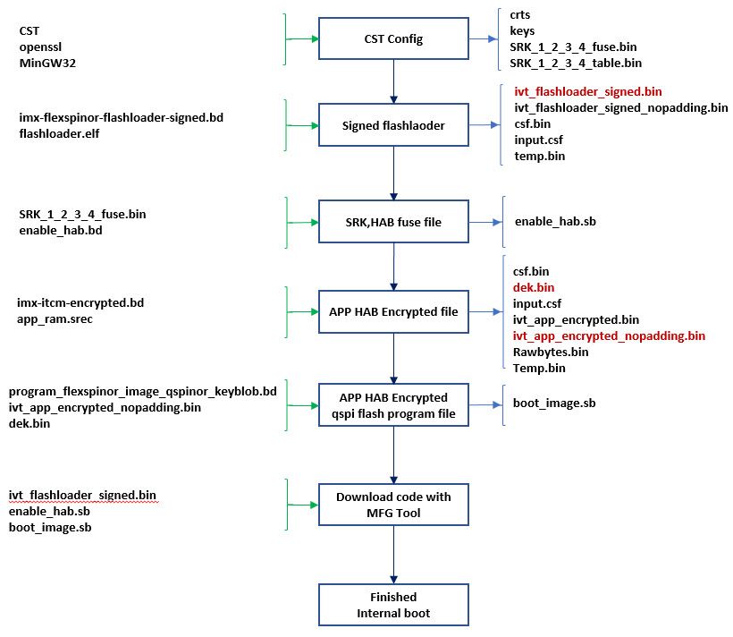

      Here is a flow chart of the overall HAB encryption operation step, after checking this figure, then we will follow it step by step.
Fig 2. MXRT1050 HAB encrypted image flow chart

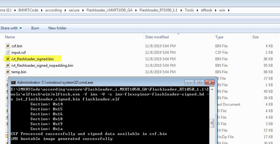

Please open commander window under the elftosb folder, then input this commander:
elftosb.exe -f imx -V -c imx-flexspinor-flashloader-signed.bd -o ivt_flashloader_signed.bin flashloader.elf
Fig 3.  Sign flashloader
 This steps will generate the  ivt_flashlaoder_signed.bin, which is needed to put under the MFGtool OS Firmware folder, just used for enter the signed flashloader mode.

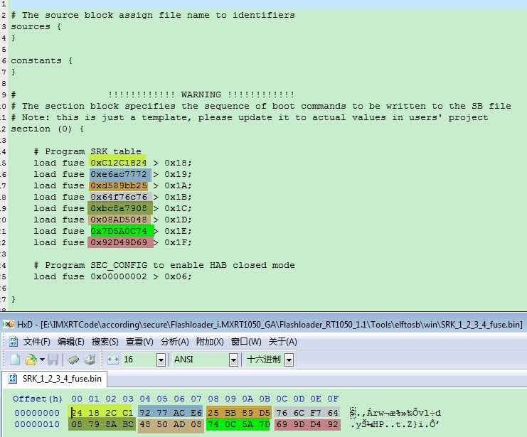

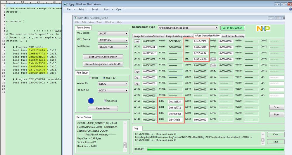

Please refer to the chapter 2.1 generated SRK_1_2_3_4_fuse.bin, modify the enable_hab.bd like the following picture:
Fig 4. enable_hab.bd SRK and HAB mode fuse modification
Then,  in the elftosb window, please input the following command, just used to generate the enable_hab.sb program file:
elftosb.exe -f kinetis -V -c enable_hab.bd -o enable_hab.sb
Fig 5. SRK and HAB mode program files generation

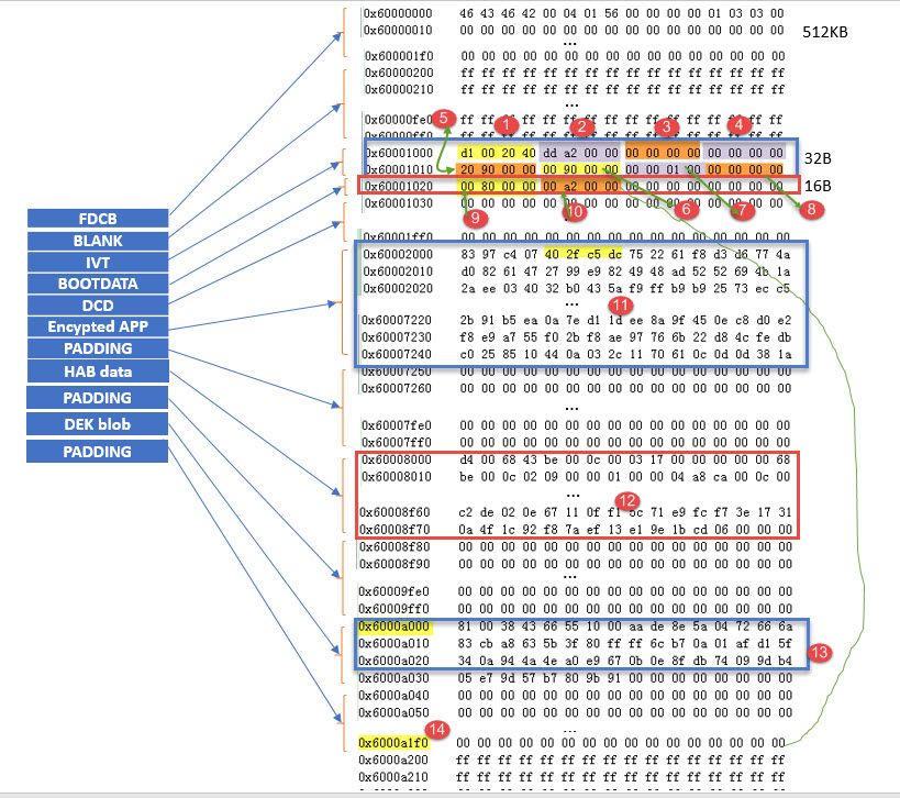

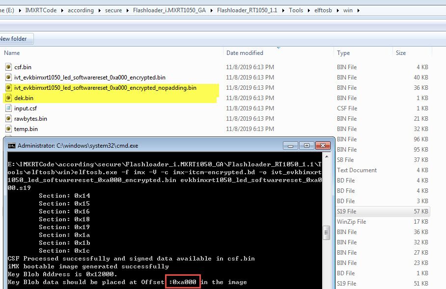

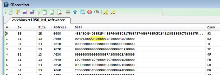

Please note, we need to record the generated key blob offset address, it is 0XA00, just like the above data in the red frame, this address will be used in the next chapter’s .bd file. After this step, it will generate 7 files:
         (1)  ivt_evkbimxrt1050_led_softwarereset_0xa000_encrypted.bin, this file includes the FDCB which is filled with 0, IVT, BD, DCD, APP HAB encrypted image data, CSF data
(2)  ivt_evkbimxrt1050_led_softwarereset_0xa000_encrypted_nopadding.bin, compare with ivt_evkbimxrt1050_led_softwarereset_0xa000_encrypted.bin, this file deletes the 0s which is above IVT range.

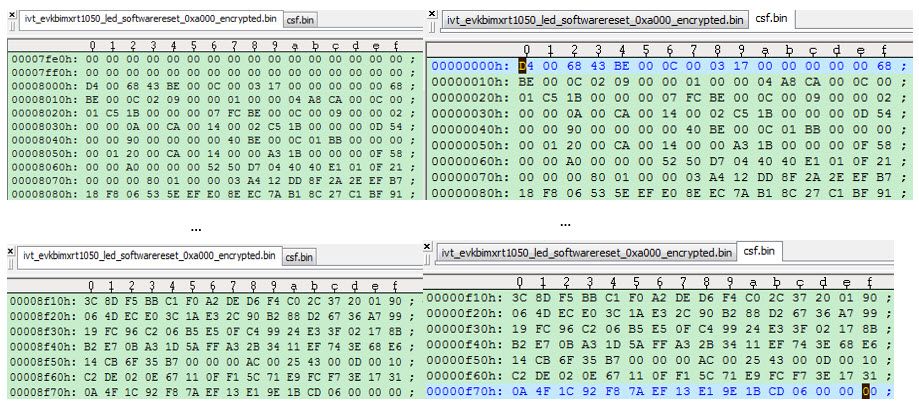

(3)  Csf.bin, it is the HAB data area, you can find the data contains the csf data, it is from 0X8000 to 0X8F80 in the generated ivt_evkbimxrt1050_led_softwarereset_0xa000_encrypted.bin.
Fig 8. Csf data and the encrypted app relationship
     (4) dek.bin
Fig 9. Dek data
DEK data is the AES-128 bits key, it is not defined by the customer, it is random generated automatically by the HAB encrypted tool.

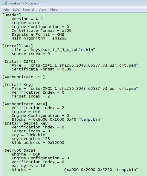

(5) input.csf
Open it, you can find the following content:
Fig10. Input csf file content
(6) rawbytes.bin,  this is the app image plaintext data, it doesn’t contains the FDCB,IVT,BOOTDATA, DCD, csf etc.
   (7) temp.bin, it is the temporary file, compare with ivt_evkbimxrt1050_led_softwarereset_0xa000_encrypted.bin, no csf files.

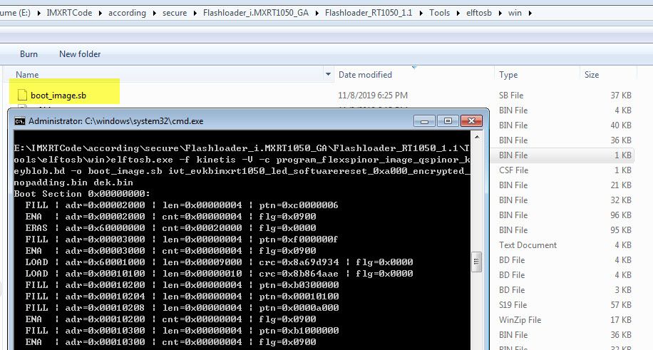

Now, combine program_flexspinor_image_qspinor_keyblob.bd, ivt_evkbimxrt1050_led_softwarereset_0xa000_encrypted_nopadding.bin
and dek.bin file together, we use the following commander to generate the boot_image.sb:
elftosb.exe -f kinetis -V -c program_flexspinor_image_qspinor_keyblob.bd -o boot_image.sb ivt_evkbimxrt1050_led_softwarereset_0xa000_encrypted_nopadding.bin dek.bin
Fig 11. App HAB encrypted program file generation
Until now, we will find, all the related HAB encrypted files is prepared.

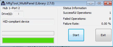

Then open the tool MfgTool2.exe, the board MIMXRT1050-EVKB(need to modify the on board resistor, use the qspi flash) mode should be serial download mode, just modify SW7:1-OFF,2-OFF,3-OFF, 4-ON, connect two usb cable between PC and the board J28 and J9. After the connection, you will find the MfgTool2.exe can detect the HID device:
Fig 12. MFG tool program
After the program is finished, power off the board, modify the boot mode to internal boot, it is SW7:1-OFF,2-OFF,3-ON, 4-OFF,connect the COM terminal, power on the EVKB board, after reset, you will find the D18 led is blinking, after you press the SW8, you will find the following printf information:
BOARD RESET start.
 Helloworld.
WAKEUP key pressed, will do software system reset.
 BOARD RESET start.
 Helloworld.‍‍‍‍‍‍‍‍‍‍‍‍‍
So, the HAB encrypted image works OK now.

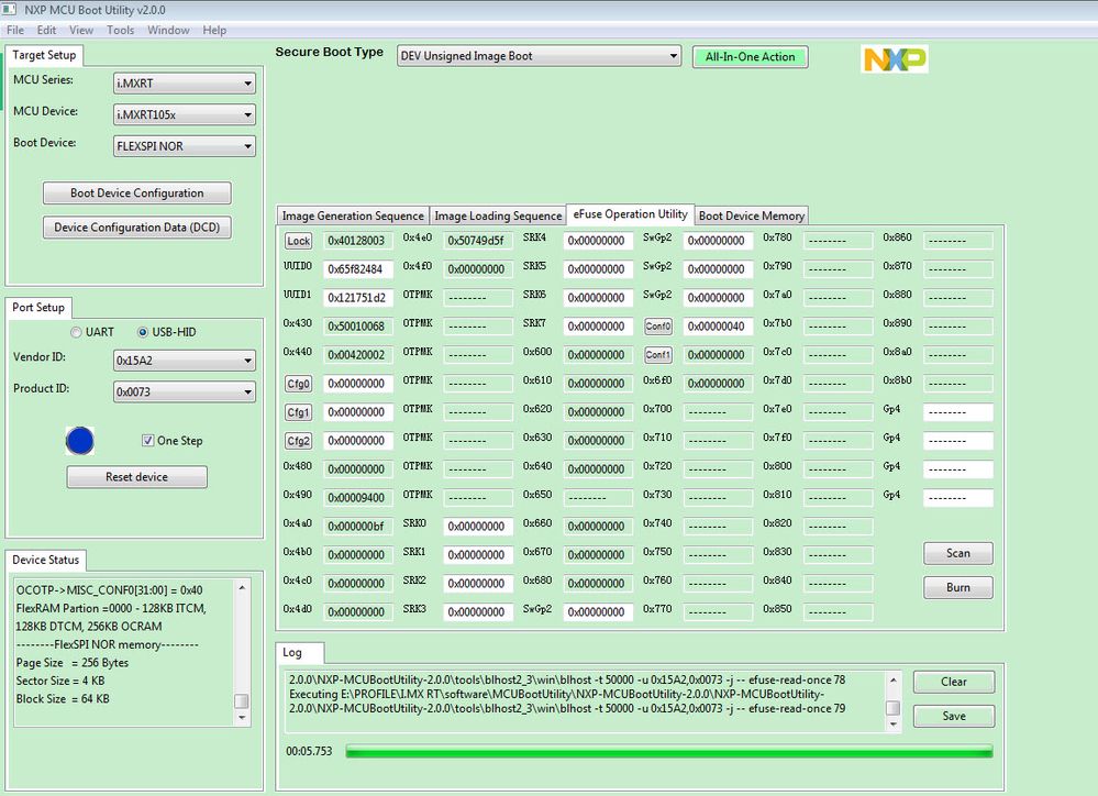

3.1 MCUBootUtility Configuration to check the RT Encrypted image
     Here, we can also use  MCUBootUtility tool to check the RT chip encrypted image and the fuse data.
     If the cst is your own configured, please do the following configuration at first:
    (1)Copy the configured cst folder to folder:
NXP-MCUBootUtility-2.0.0\tools
Delete the original cst folder.
(2)Copy SRK_1_2_3_4_fuse.bin and SRK_1_2_3_4_table.bin to folder:
 NXP-MCUBootUtility-2.0.0\gen\hab_cert

3.1 RT1050 fuse map comparation
Before do the HAB encrypted image program, I have read out the whole fuse map as follows:
Fig 13. MIMXRT1050-EVKB fuse map before HAB encrypted image
Fig 14. MIMXRT1050-EVKB fuse map after HAB encrypted image
Compare the fuse map between do the HAB encrypted image and no HAB encrypted image, we can find two difference:
  • HAB mode, 0X460 bit1:0 open, 1 close
  • SRK area
We can find, after program the HAB encrypted image, the SRK fuse data is the same as the SRK data which is defined in the enable_hab.bd.

From MCUBootUtility tool, we can find the HAB Encypted image structure should be like this:
Fig 15. HAB Encrypted image structure
What about the real example image case? Now, we use the MCUbootUtility tool to read out our HAB encrypted image, from address 0X60000000, the readout size is 0XB000. The detail image structure is like following:
Fig 16. HAB Encypted image example structure
1): IVT:  hdr,  IVT header, more details, check hab_hdr
2):    IVT: entry, the app entrypointAddress, it should be the reset_handler address, in this document example, it is the address 0xa004 data, the plaintext is 0X00A2DD, but after the HAB encrypted, we can find the address -x60002004 data is the encrypted data
3):  IVT: reserved
4):  IVT: DCD, it is used for the DRAM SEMC configuration, in this example, we didn’t use the SDDRAM, so the data is 0.
5):  IVT: BOOT_DATA, used to indicate the BOOT_DATA  RAM start address 0X9020.
6):  IVT: self, ivt self RAM start address is 0X9000
7):  IVT:CSF, it is used to indicate the CST start address, this example csf ram address is 0X00010000.
8):  IVT:reserved
9): BOOT_DATA:  RAM image start,  the whole image RAM start address, this RAM example BOOT_DATA is 0X8000,0XA000-0X2000=0X8000
10): BOOT_DATA: size, APP file size, it is 0X0000A200, after checking the file generated HAB encrypted app image size, you can find the image end size is really 0XA200, just like the fig 16.
11):  HAB  Encypted app data,  please check ivt_evkbimxrt1050_led_softwarereset_0xa000_encrypted.bin file, the address 0X2000-0X7250 data, you will find it is the same.
12): HAB data, it incluses the csf, certificate etc data, you can compare the file ivt_evkbimxrt1050_led_softwarereset_0xa000_encrypted.bin address 0X8000-0x8f70 data, it is the same.
13):DEK blob, it is the DEK key blob related data, the offset address is 0XA000, the same as fig 7.
FDCB,IVT,BOOT DATA are all plaintext, but app image area is the HAB encrypted data, HAB and the DEK blob is the generated data put in the related memory.
