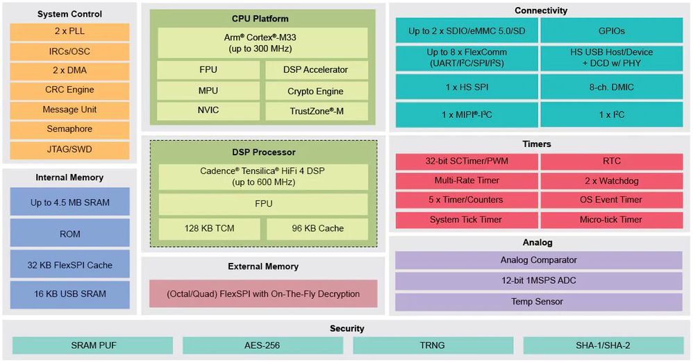

The RT6xx is a crossover MCU family is a breakthrough product combining the best of MCU and DSP functionality for ultra-low power secure Machine Learning (ML) / Artificial Intelligence (AI) edge processing, performance-intensive far-field voice and immersive 3D audio playback applications. Fig 1 is the block diagram for the i.MX RT600.
It consists of a Cortex-M33 core that runs up to 300 MHz with 32KB FlexSPI cache and an optional HiFi4 DSP that runs up to 600MHz with 96KB DSP cache and 128KB DSP TCM. It also contains a cryptography engine and DSP/Math accelerator in the PowerQuad co-processor. The device has 4.5MB on-chip SRAM. Key features include the rich audio peripherals, the high-speed USB with PHY and the advanced on-chip security. There is a Flexcomm peripheral that supports the configuration of numerous UARTs, SPI, I2C, I2S, etc.
Fig 1

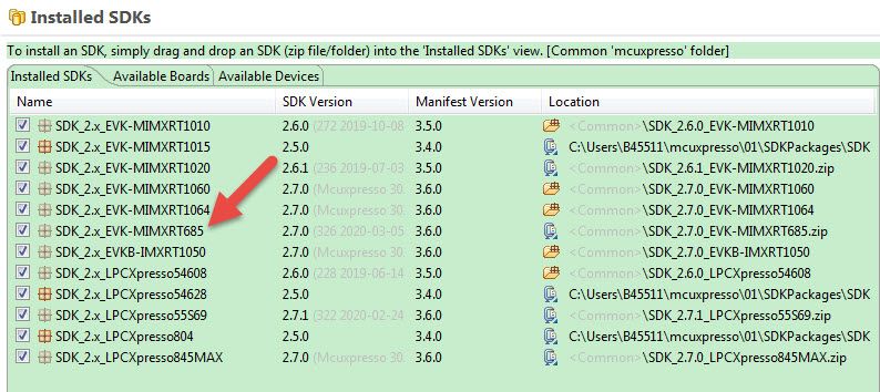

  • Install SDK library
Fig 2
  • Create a new C++ project using installed SDK Part
    In the MCUXpresso IDE User Guide, Chapter 5 Creating New Projects using installed SDK Part Support presents how to create a new project, please refer to it for details

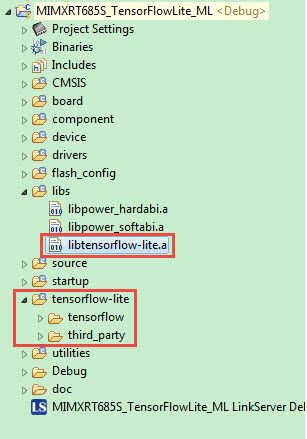

Porting tensorflow-lite
  • Copy the tensorflow-lite library to the target project
    Copy the TensorFlow-lite library corresponding files to the target project
Fig 3

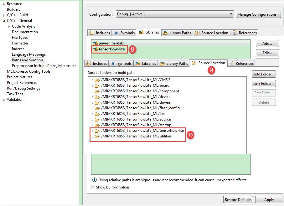

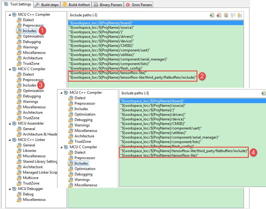

  • Add the paths for the above files
Fig 4
Fig 5
Fig 6

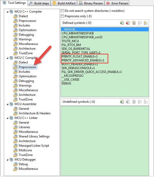

  • In default, the created project doesn't support print float, so it needs to enable this feature by adding below symbols (Fig 10).
Fig 10

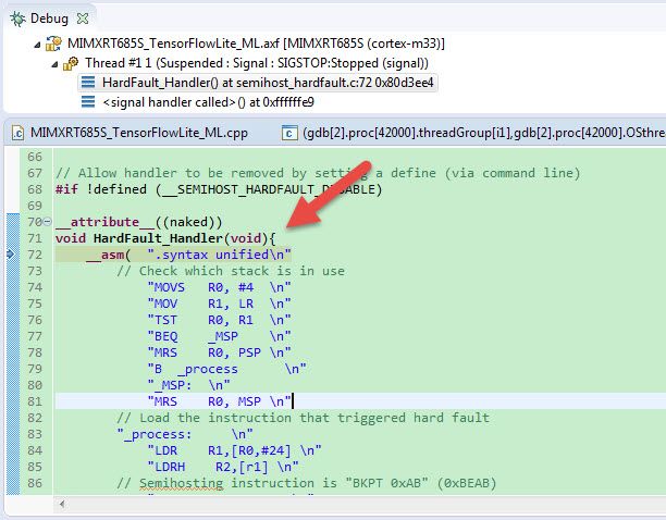

  • When a neural network is executed, the results of one layer are fed into subsequent operations and so must be kept around for some time. The lifetimes of these activation layers vary depending on their position in the graph, and the memory size needed for each is controlled by the shape of the array that a layer writes out. These variations mean that it’s necessary to calculate a plan over time to fit all these temporary buffers into as small an area of memory as possible. Currently, this is done when the model is first loaded by the interpreter, so if the area is not big enough, you’ll see a crash event happen.
    Regard to this application demo, the default heap size is 4 KB, obviously, it's not big enough to store the model’s input, output, and intermediate tensors, as the codes will be stuck at hard-fault interrupt function (Fig 11).
Fig 11

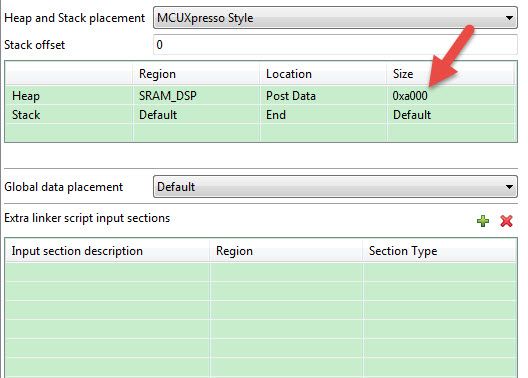

So, how large should we allocate the heap area? That’s a good question. Unfortunately, there’s not a simple answer. Different model architectures have different sizes and numbers of input, output, and intermediate tensors, so it’s difficult to know how much memory we’ll need.
The number doesn’t need to be exact—we can reserve more memory than we need—but since microcontrollers have limited RAM, we should keep it as small as possible so there’s space for the rest of our program.
We can do this through trial and error. For this application demo, the code works well after increasing ten times than the previous heap size (Fig 12).
Fig 12
