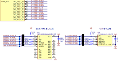

I'm attempting to test a FlexSPI2 memory device on my custom 1064 MCU based board using NXP's 'evkmimxrt1064_flexspi_nor_polling_transfer' example...
the example code works and I can access an external NOR flash device okay modifying the example code's clock, pin-mux configuration and LUT, etc. to match my FlexSpiA flash device's pin and LUT.
But when I try to modify the example code to use FlexSpi B instead of FlexSpi A to access another memory device on the FlexSpi B bus, the code crashes when the FlexSpi2 Clock Mux and/or Clock Div are configured.  I suspect the problem I am having has to do with the clock setup/configuration (clock_config.c) because the code crashes when the FlexSpi2 (B) clock is configured, even before the FlexSpi driver API is initialized (crash happens in red colored code, below).

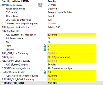

Adding pin mux and clock config...

Device seems to crash when the clock for FlexSPI2 is turned on.

To clarify, one device is connected to FlexSPIA, and the other to FlexSPIB.

Firstly, the RT1064 runs code in the internal Flash which connects the FlexSPI2, so it should forbid executing the code below code.
Secondly, it needs to configure the pin as the FLEXSPI_DQS besides the FLEXSPI_DATA, FLEXSPI_CLK, FLEXSPI_SS.

Hi @mjpovi ,
According to your statement, your customize board contains two external QSPI which connect to the FlexSPI2, and it's able to access one, but, fails to access another, is my understanding right?
To be prudent, I was wondering if you can share the schematic of the board.
