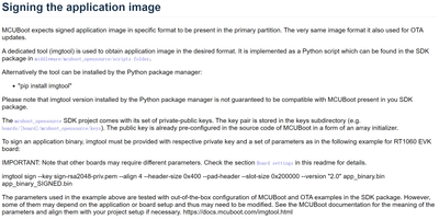

The original purpose of this topic is to sign OTA  firmware that can be loaded by MCUBOOT example. I did the following steps, then it works.
1. copy "mcuboot_opensource" directory from SDK to OTA example project's "scripts" directory.
2. delete the original post build steps script, and replaced with "python ../scripts/mcuboot_opensource/scripts/imgtool.py sign --key ../keys/sign-rsa2048-priv.pem --align 4 --header-size 0x400 --pad-header --slot-size 0x200000 --version "1.0.2" evkmimxrt1180_ota_mcuboot_server_enet_cm33.bin ota_example_SIGNED_APP2_V1.0.2.bin"
3. build OTA example, right click the evkmimxrt1180_ota_mcuboot_server_enet_cm33.axf file in the Project Explorer, click "Binary Utilities"->"Create binary". Then build again. So I have the signed bin file.

1. There is known issue about `ota_mcuboot_server_enet_cm33` or  `mcuboot_opensource_cm33` for RT1180 SDK as you mentioned, please see below picture and comments(ota_mcuboot_server_enet_cm33\scripts\mcuxpresso\readme), it seems be not able to work with IDE + image_hash_tool.py, and you have to use imgtool to do that.

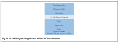

2. About AHB, please see MCU-OTA SBL and SFW User Guide to find 5.1.1 High Assurance Boot (HAB),It is the high-assurance boot feature in the system boot ROM, that detects and prevents the execution of unauthorized software (malware) during the boot sequence.
HAB uses asymmetric cryptography to sign the image. The bootable image can be signed by the CST tool (another one tool).
