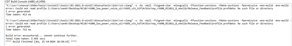

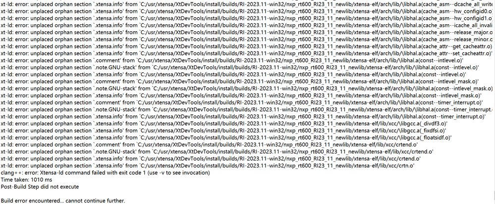

Dear NXP team, when I debug "rt685_vit_hifi4" in "rt600_low_power_voice_ui" on Xtensa Xplorer IDE, an error message appears as shown in the attachment. What is the reason?f172bc59d7f59b0c6f30a1797896937.png

Hi @Zhaozhiling,
I believe the first issue might be related to an improper linker file, which results in objects being misplaced or not placed at all on adequate memory locations. With respect to the second issue, it seems like the IDE is not finding the file "profile.profdata" on the shown path. For support of both modifying the linker file and linking the proper paths for the compilation process, I would highly recommend you contact Cadence support, as this seems to be an IDE related issue more than an RT600 issue.

Compiling on my colleague's PC has the following problem again, why is this?4f10a360a2bf380495e576b649c32ed.png
