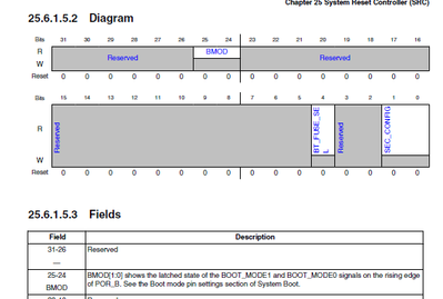

jay_heng
Can you readout SRC->SBMR2 register by debugger? its base address is 0x40C0_400C
We usually check this register to see whether boot mode setting is valid.
