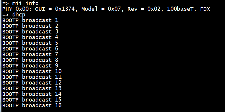

I'm working on uboot 2015.04, want to boot uImage from tftp, but i cann't obtain ip from dhcp. i use AR8035 phy, follow is my error.
does everybody can help ?

Correction. The change required in the same file is:
#define CONFIG_FEC_ENET_DEV        0
Still not sure how to configure this without changing the header file manually
1,255 Views
danielbujak
1,254 Views
danielbujak
I was able to get this working by defining CONFIG_CMD_NET in mx6ul_14x14_evk.h manually like so:
#ifndef CONFIG_CMD_NET
#define CONFIG_CMD_NET
#endif
I'm not sure how you're supposed to configure this though. It seems like normally it would be under "Command Line Interface" in the uboot-menuconfig however this option is not available in the uBoot version supplied by NXP.
Hopefully that's a workaround for you as well, but I'd like to know how we're supposed to enable this in the buildroot environment.
