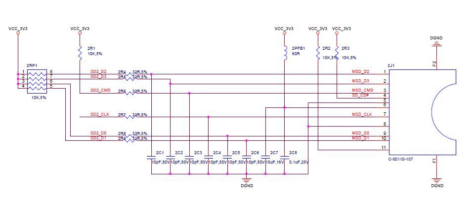

Hi all,
I am working on IMX6q custom board.
I am using IMX6 android4.3 BSP from freescale
when setting sd4 for micro sd , i got mmc timeout message
and i can't mount sd crad on my system

MX6Q_PAD_NANDF_ALE__USDHC4_RST,
MX6Q_PAD_DISP0_DAT2__GPIO_4_23,

i dont know why i can't mount sd card on my system
Thanks.

Rita_Wang
Hi tsai derek,
What's about your hardware design? The SD4 is connected to emmc or sd? Are you refer to our reference design board MCIMX6Q-SDP/MCIMX6Q-SDB?
Dan

tsaiderek
Hello Dan,
Thanks for your reply,
SD4  connect to SD, when  i use this design for SD2, everything is ok
but if change  to SD4,
i got timeout message
9,681 Views
