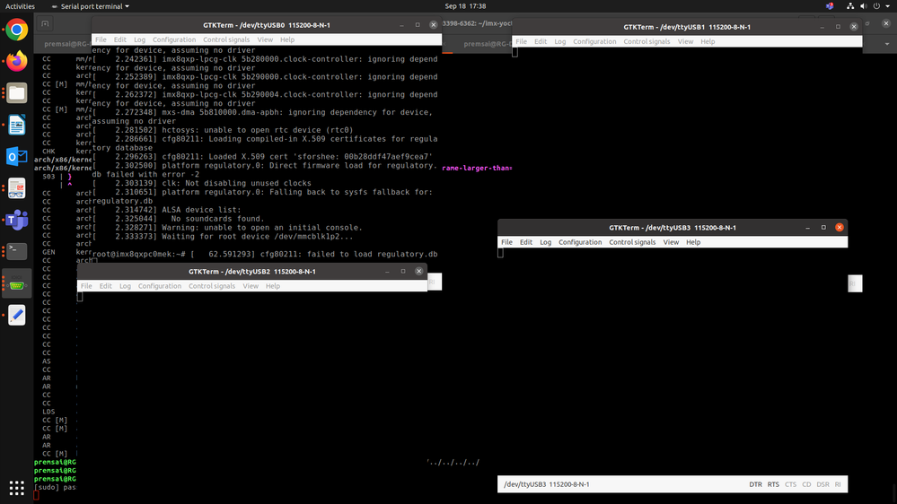

i am using imxqxpc0mek board (yocto build), when i run jh_mmcboot in u-boot i am facing the following issue.

Hi Peng,
i have changed the console=ttyLP1 and the inmate cell is booting but unable to mount rootfs.
And if i change to ttyLP0 and ttyLP3 as well i can see the same logs as mentioned above.

Hi Peng,
Thanks for the input.
After setting the bootargs which you have suggested, i can see that my inmate is starting on the same console(0x5a060010). but the logs are stopping after reaching : [ 0.912188] printk: bootconsole [lpuart32] disabled
.The below is the log provided after running my linux-demo-cell.
My requirement is to get the logs in another uart port(0x5a070010). I am using gtkterm and my rootcell logs are coming on ttyUSB0 which is ttyLP0(0x5a060010). and the second uart is ttyUSB1 which is ttyLP1(0x5a070010).
Please correct if my Understanding is Wrong.
root@imx8qxpc0mek:~# jailhouse cell linux /usr/share/jailhouse/cells/imx8qxp-linux-demo.cell /run/media/mmcblk1p1/Image -d /run/media/mmcblk1p1/imx8qxp-mek-inmate.dtb -c "clk_ignore_unused console=ttyLP2,115200 earlycon=lpuart32,mmio32,0x5a060010,115200 cma=32MB root=/dev/mmcblk0p2 rootwait rw"

sai9
Hi Peng,
I gave the below command, the initial logs and kernel logs are being pushed into the root cell (ttyLP0). There is no data on any of the other three ports (I have attached a screen shot).
root@imx8qxpc0mek:~# jailhouse cell linux /usr/share/jailhouse/cells/imx8qxp-linux-demo.cell /run/media/mmcblk1p1/Image -d /run/media/mmcblk1p1/imx8qxp-mek-inmate.dtb -c "clk_ignore_unused console=ttyLP2,115200 earlycon=lpuart32,mmio32,0x5a060010,115200 cma=32MB root=/dev/mmcblk1p2 rootwait rw"
And even in the ttyLP0 port, the inmate cell is not booting further.
[ 2.333373] Waiting for root device /dev/mmcblk1p2...
I have one quick question, did you mean here ttyLP2 is rs232 port or the uart port from same USB?
I have the rootfs in sd card which is at mmcblk1p2 partition and using mmcblk0p2 gives a kernel panic error.

[ 2.281502] hctosys: unable to open rtc device (rtc0)
[ 2.286661] cfg80211: Loading compiled-in X.509 certificates for regulatory database
[ 2.296263] cfg80211: Loaded X.509 cert 'sforshee: 00b28ddf47aef9cea7'
[ 2.302500] platform regulatory.0: Direct firmware load for regulatory.db failed with error -2
[ 2.303139] clk: Not disabling unused clocks
[ 2.310651] platform regulatory.0: Falling back to sysfs fallback for: regulatory.db
[ 2.314742] ALSA device list:
[ 2.325044] No soundcards found.
[ 2.328271] Warning: unable to open an initial console.
root@imx8qxpc0mek:~# [ 62.591293] cfg80211: failed to load regulatory.db
