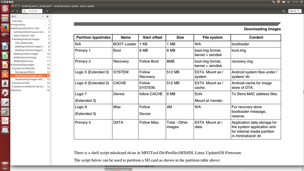

Jimmy, the copy and past layout is not very clear, I have capture the screen and upload it. please check.Storage_partitions.png
It seems the same as mksdcard-android.sh.

Jimmy, the Android User Guide Section 4.4.1 Storage partitions is shown below:
Partition type/index
Name
Start offset
Size
File system
Content
N/A BOOT Loader 1 KB 1 MB N/A bootloader
Primary 1 Boot 8 MB 8 MB boot.img format,
kernel + ramdisk boot.img
Primary 2 Recovery Follow Boot 8MB boot.img format,
kernel + ramdisk recovery.img
Logic 5 (Extended 3) SYSTEM Follow
Recovery 512 MB EXT4. Mount as /
system Android system files under /
system/ dir.
Logic 6 (Extended 3) CACHE Follow
SYSTEM. 512 MB EXT4. Mount as /
cache. Android cache for image
store of OTA.
Logic 7 Device follow CACHE 8 MB Ext4. To Store MAC address files.
(Extended 3)
Logic 8
Mount at /vender.
Misc
(Extended 3)
Primary 4
Follow
4M N/A For recovery store
bootloader message,
reserve.
Total - Other
images EXT4. Mount at /
data. Application data storage for
the system application and
for internal media partition
in /mnt/sdcard/ dir.
Device
DATA
Follow Misc.
