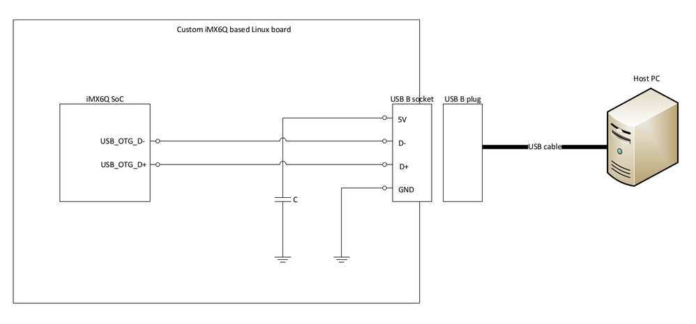

here is a quick update on how USB device port is actually wired to SoC:
As you can see I have just D+ and D- routed to my SoC, while +5V (from host) is basically just wired to capacitor and then to the GND.
VBUS sensing/detection over extcon framework is probably not possible with such configuration...?
Any other ideas?
