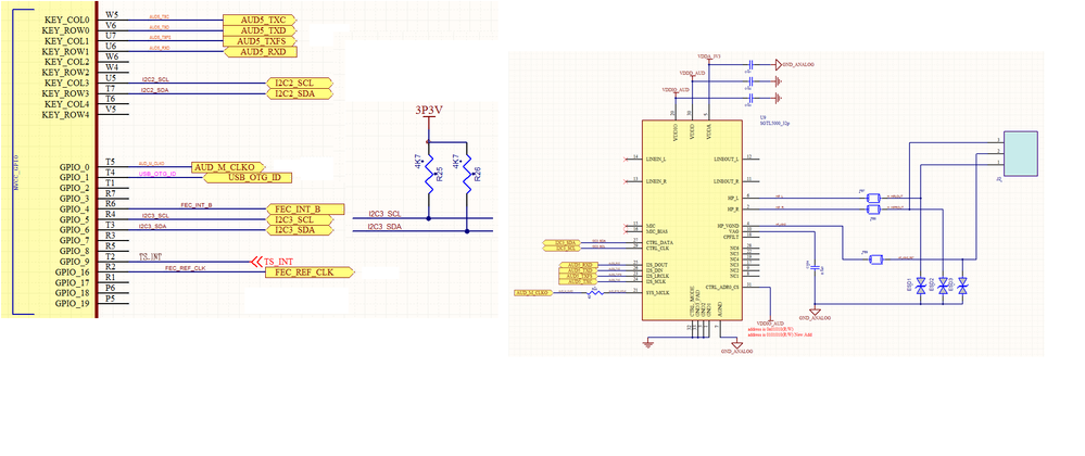

I show my schematic and the changes been done, also I attached the kernel log.
Could someone, please, take a look to my code and hardware to give me a hint on this issue?

Schematics is shown below:
Since I'm using different pads for audio, the pad mux definition is shown below:
MX6DL_PAD_KEY_COL0__AUDMUX_AUD5_TXC,                   //ALT2
MX6DL_PAD_KEY_ROW0__AUDMUX_AUD5_TXD,                //ALT2
MX6DL_PAD_KEY_COL1__AUDMUX_AUD5_TXFS,                //ALT2
MX6DL_PAD_KEY_ROW1__AUDMUX_AUD5_RXD,               //ALT2
MX6DL_PAD_GPIO_0__CCM_CLKO,                                       //ALT0
Since I'm using I2C3, the pad mux definition is shown below:
MX6DL_PAD_GPIO_5__I2C3_SCL,                                         //ALT6
MX6DL_PAD_GPIO_6__I2C3_SDA,                                        //ALT3

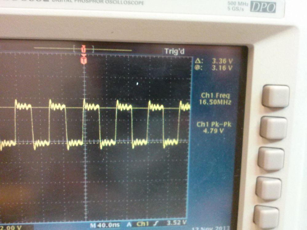

The clock signal in R44 is ahown below:

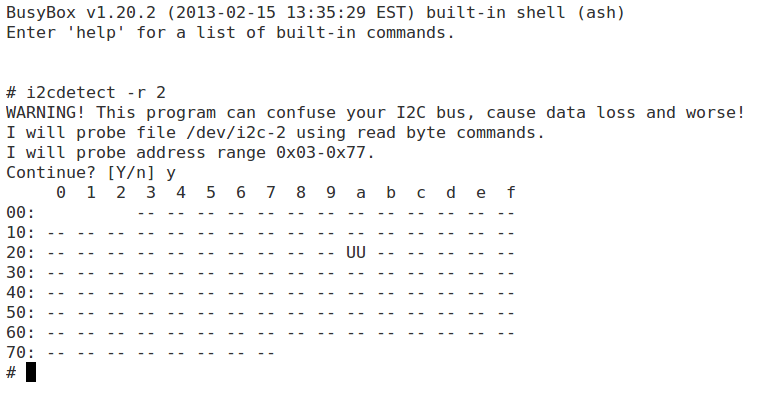

The codec sgtl5000 is been found in I2C address 0x2a as shown below:
