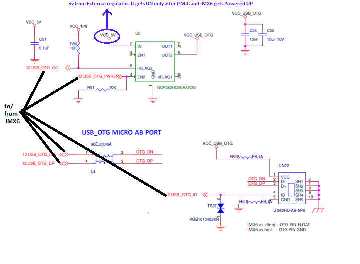

Hi All,
We have designed SOM and carrier board for iMX6.
when imx6's OTG port is connected with PC(client mode) ,imx6 voltage  domains VDDHIGH_CAP, VDDARM23, VDDARM_IN are  powered via VCC_USB_OTG pin.
No other supply is given to board SOM and carrier board.
Please help us to solve this issue..

tamilarasane
Hi igor,
In Our board, iMX6 POR released after MMPF0100 started up.
In saber design, page No.11 of SCH-27392.PDF , N and P MOSFET are used to control USB_OTG_CON_VBUS Net.
But we didn't implement this logic to control VCC_USB_OTG in  our board( i.e GEN_3V3 from PMIC controls the VCC_USB_OTG in saber )
Below is the image which shows  OTG section of our design.
Tamil

igorpadykov
Hi Tamilarasan
do you mean that MMPF0100 is starting up correctly without VIN,
only with applying VCC_USB_OTG ?
~igor

tamilarasane
Hi igor,
No, MMPF0100 is starting up correctly when VIN is applied.
we didn't analysed it for only VCC_USB_OTG applied case.
since we experienced this issue only two times and it is short lived.

igorpadykov
Hi Tamilarasan
only with applying VCC_USB_OTG, MMPF0100 should not
start up, probably there was smth wrong in boards.
~igor

mohammedazlum
I think VCC_USB_OTG [5.00V] can be sourced 5V from host PC to your board. But current is not sufficient to turn on the PMIC. Is that the problem ?
