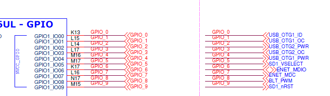

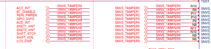

Dear  Expert:
In i.mx6ul-evk,there is a picture below:
Could you tell me what function this pin "ENET1_nINT and ENET2_nINT" is, is this pin mapped to other pin or not?
If yes, which source file will we need modify in linux?
In this picture,Could you tell me what function this pin "ENET_MDIO and ENET_MDC" is, is this pin mapped to other pin or not?If yes, which source file will we need modify in linux?
thanks for you great support.

(1)Could you tell me what function this pin "ENET1_nINT and ENET2_nINT" is, is this pin mapped to other pin or not?
--Yes, these 2 PINs can be mapped to other pins. only need 2 GPIO pins of Processor for them.
ethernet device tree file is imx6ul-14x14-evk.dts , but ENET1_nINT and ENET2_nINT are not used. so you also don't need to modify source code about them.
(2)In this picture,Could you tell me what function this pin "ENET_MDIO and ENET_MDC" is, is this pin mapped to other pin or not?If yes, which source file will we need modify in linux?
--ENET_MDIO and ENET_MDC are management pins of Ethernet, From I.MX6UL reference manual, They can be routed via other PADs:
these 4 signals can also be configured in imx6ul-14x14-evk.dts, but on i.mx6ul evk board, use one MDC & MDIO to mange 2 Ethernet, see following, please:
        pinctrl_enet2: enet2grp {
            fsl,pins = <
                MX6UL_PAD_GPIO1_IO07__ENET2_MDC        0x1b0b0
                MX6UL_PAD_GPIO1_IO06__ENET2_MDIO    0x1b0b0
                MX6UL_PAD_ENET2_RX_EN__ENET2_RX_EN    0x1b0b0
                MX6UL_PAD_ENET2_RX_ER__ENET2_RX_ER    0x1b0b0
                MX6UL_PAD_ENET2_RX_DATA0__ENET2_RDATA00    0x1b0b0
                MX6UL_PAD_ENET2_RX_DATA1__ENET2_RDATA01    0x1b0b0
                MX6UL_PAD_ENET2_TX_EN__ENET2_TX_EN    0x1b0b0
                MX6UL_PAD_ENET2_TX_DATA0__ENET2_TDATA00    0x1b0b0
                MX6UL_PAD_ENET2_TX_DATA1__ENET2_TDATA01    0x1b0b0
                MX6UL_PAD_ENET2_TX_CLK__ENET2_REF_CLK2    0x4001b031
So if you want re-map them, you can modify above 2 lines with Bold.
