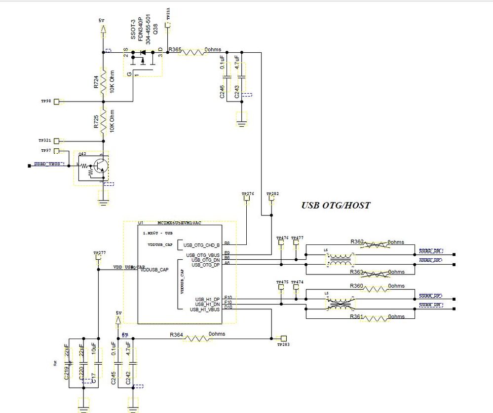

Our new project now customer feedback an issue is that  usb device disconnect from computer sometimes but it can recover connect immediately.
MCU module: MCIMX6U5EVM10AC
Action:
1. USB eye diagram test is OK ,
2. if USB device connected to computer then remove the usb cable , but measured the USB_OTG_VBUS still output 4.4V(all of the products) .could you please help how to shut down the USB_OTG_VBUS?

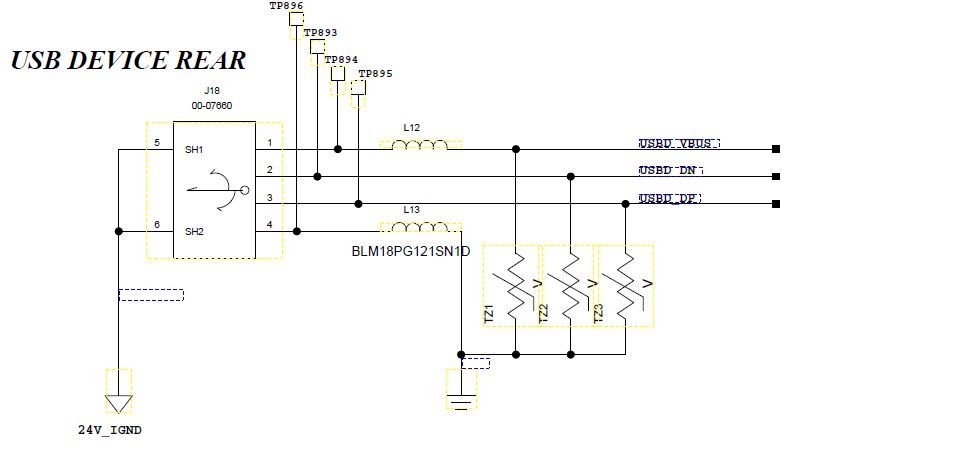

zhongweihe
Hi igorpadykov,
    Thanks your good support , up is our project about USB signal part .
1. Our USB not with OTG function ,
2. Signal USB_OTG_DN/USB_OTG_DP connect to USB type B connector directly as a device .
3. First time power up ; 1.  if not connect USB cable to computer , the USB_OTG_VBUS =0V .
                                         2. if connect USB cable to computer ,the USB_OTG_VBUS =5V , then if remove the
                                             USB cable from computer ,the USB_OTG_VBUS=4.4V( Generallly , if remove the USB
                                             USB cable from computer , the USB_OTG_VBUS should be 0V) so please help to check
                                            why the USB_OTG_VBUS still output 4.4V if remove the USB cable from computer ?
2,256 Views
igorpadykov
Hi zhongwei
had custom board design followed i.MX6Q Sabre SD schematic.
If not, suggest to proceed with help of Commercial Support and Engineering Services | NXP
igor
