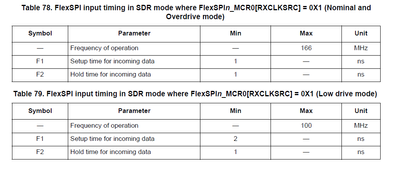

joanxie
I confirmed that imx93 doesn't have this issue,  you can try to use this bit directly, for the clock, pls refer to the data sheet as below
2,108 Views
Niebel-TQ
Just a follow up question. The mode 10b (SCLK output clock and looped back from SCLK pad) is not mentioned in the data sheet. What is the SCLK rate that is achievable in this mode?
