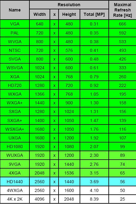

I have confused i.mx6q dual display options.
Please tell me the answer for below yes/no questions.
It will be run in linux or android.
1. Same image Same resolution (ex. 1280x720 in LVDS and 1280x720 HDMI) <- maybe yes
2. Same image Different resolution (ex. 1280x720 in LVDS and 1920x1080 HDMI)
3. Different image Same resolution (ex. 1280x720 in LVDS and 1280x720 HDMI and different image)
4. Different image Dirrerent resolution (ex. 1280x720 in LVDS and 1920x1080 HDMI and different image)
Thank you.

Hi JHY
this depends on what do you mean.
How many fps and how they are connected to
IPUs (one IPU for two LCDs or two IPU, one per LCD)
igor

Hi JHY
below theoretical capability per one IPU
however real application may have less capabilities due to
processor/memory bandwidth limitations.
igor

Thank you for your reply.
But I am not sure that HD720 + HD1080 dual display is possible.
How can I determine for that?
