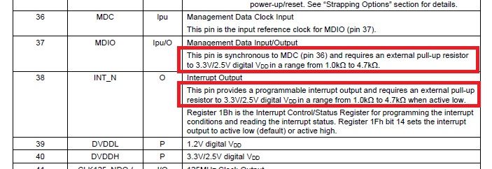

Thank you for your reply. Actually, what I was referring to is the PHY side.
Ok RGMII_MDC, RGMII_MDIO, ENET_REF_CLK, RGMII_INT are NVCC_ENET = 3.3V
But aren't they on 2.5V on the PHY side?
Durmus

durmus
Hi chipexpert,
Below are screenshots from related sections of KSZ9021RN and AR8031 (phy used in SABRE SDP). Links to datasheets are also included.
KSZ9021RN
AR8031
It says pull-up to 3.3V / 2.5V and since digital level of PHY is 2.5V in SABRE SDP, I thought they should have been pulled-up to 2.5V instead of 3.3V.
Thanks.

igorpadykov
Hi Durmus
first please look at attached part of AR8031 datasheet.
Second, regarding your statement
"It says pull-up to 3.3V / 2.5V and since digital level of PHY is 2.5V in SABRE SDP, I thought
they should have been pulled-up to 2.5V instead of 3.3V." -
Why do you think that "they should have been pulled-up to 2.5V instead of 3.3V." ?
Datasheet allows for both 3.3V and 2.5V.
chip

durmus
Hi chiexpert,
Firstly, ok, my mistake. The link I provided is an old revision of datasheet. The one where I took the screenshot from has a date of August, 2011. Hence more recent, and must be more valid.
Secondly, I believe what they are referring to is not a range of 2.5V-3.3V, but the selection of voltage level of digital interface you are using (i.e. either 2.5V or 3.3V). Therefore, if you are using
2.5V for digital interface (which is the case), using 3.3V for pull-ups seem.
2,533 Views
igorpadykov
Hi Durmus
these interfaces are all "digital".
Only i.MX6 RGMII_RXDn,RGMII_RTXDn are on NVCC_RGMII = 2.5V.
Other - at NVCC_ENET = 3.3V power domain
