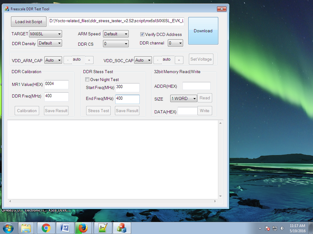

I ran the ddr stress test on my custom board and i got the following error:
        DDR Stress Test (2.5.2)
        Build: Mar 31 2016, 23:06:03
        Freescale Semiconductor, Inc.
        Chip ID
CHIP ID = i.MX6 SoloLite (0x60)
Internal Revision = TO1.2
        Boot Configuration
SRC_SBMR1(0x020d8004) = 0x00002c40
SRC_SBMR2(0x020d801c) = 0x31000001
ARM Clock set to 1GHz
        DDR configuration
DDR type is LPDDR2 in 1-channel mode.
Data width: 32, bank num: 8
Row size: 14, col size: 10
Both chip select CSD0 and CSD1 are used
Density per chip select: 512MB
Density per channel: 1024MB
DDR Stress Test Iteration 1
Current Temperature: 55
DDR Freq: 297 MHz
t0.1: data is addr test
Address of failure: 0xa0000000
Data was: 0x9fffffc0
But pattern  should match address
Error: failed to run stress test!!!
here is the parameter which i set for the ddr stress test.

igorpadykov
Hi Devi
for ddr test questions please create new thread.
