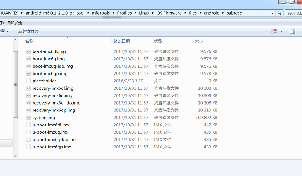

Hi Dear Suppport,
I faield to download board images with mfgtool.
I downloaded the mfgtool for Andriod6 and copy the img from "android_M6.0.1_2.1.0_image_6qsabreauto.tar.gz" to "E:\android_m6.0.1_2.1.0_ga_tool\mfgtools\Profiles\Linux\OS Firmware\files\android\sabresd" , like this:

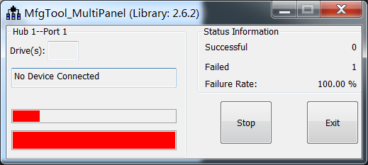

Then I ran  wmfgtool2-android-mx6dl-sabresd-emmc.vbs to get error message below:
My board is IMX6S, and I option as the  "Android™ User's Guide, Rev. M6.0.1_2.1.0, 07/2016".
My board changed the phy to lan8720 and have no norflash. We can ran it with Linux3.14.28 so the board is ok.
Then mfg log:
DLL version: 2.6.2
Thursday, November 02, 2017 11:45:10 Start new logging
ModuleID[2] LevelID[10]: CMyExceptionHandler thread is running
ModuleID[2] LevelID[1]: new MxHidDeviceClass
ModuleID[2] LevelID[10]: new MxHidDevice[004DFC78]
ModuleID[2] LevelID[10]: new MxHidDevice[004E0270]
ModuleID[2] LevelID[10]: new MxHidDevice[055DFF48]
ModuleID[2] LevelID[10]: new MxHidDevice[02119050]
ModuleID[2] LevelID[10]: new MxHidDevice[02122B10]
ModuleID[2] LevelID[10]: new MxHidDevice[05609750]
ModuleID[2] LevelID[10]: DeviceTypeDisk--_devices size: 1
ModuleID[2] LevelID[10]: Volume--StorageDisk, Disk->_driveNumber:1, Volume->_diskNumber:1
ModuleID[2] LevelID[10]: DeviceTypeDisk--find Disk device: 055E8200
ModuleID[2] LevelID[10]: Device::hubIndex::getmsc, return the port index is: 8
ModuleID[2] LevelID[10]: Device Manager thread is running
ModuleID[2] LevelID[1]: Can't set m_hStopEvent before it initialized or it already stop
ModuleID[2] LevelID[10]: CmdOperation[0] device chagned and reset to state 0
ModuleID[2] LevelID[10]: CmdOperation[0], skip current command, so SetEvent(hDevCanDeleteEvent)
ModuleID[2] LevelID[10]: ExecuteCommand--Boot[WndIndex:0], File is E:\android_m6.0.1_2.1.0_ga_tool\mfgtools\Profiles\linux\OS Firmware\firmware\u-boot-imx6dlsabresd_sd.imx
ModuleID[2] LevelID[1]: MxHidDevice::Write() Error writing to device 0x79.
ModuleID[2] LevelID[1]: Failed to initialize memory!
ModuleID[2] LevelID[1]: PortMgrDlg(0)--MxHidDevice--Command Boot excute failed
ModuleID[2] LevelID[10]: CmdOperation[0], current command executed failed, so SetEvent(hDevCanDeleteEvent)
ModuleID[2] LevelID[10]: DeviceManager::DevChangeWnd::OnDeviceChange() - DEVICE_REMOVAL_EVT(\\?\USB#VID_15A2&PID_0061#5&4e3c163&0&1#{a5dcbf10-6530-11d2-901f-00c04fb951ed})
ModuleID[2] LevelID[10]: DeviceManager::DevChangeWnd::OnDeviceChange() - end
ModuleID[2] LevelID[10]: DeviceManager::OnMsgDeviceEvent() - DEVICE_REMOVAL_EVT(\\?\USB#VID_15A2&PID_0061#5&4e3c163&0&1#{a5dcbf10-6530-11d2-901f-00c04fb951ed})
ModuleID[2] LevelID[10]: DeviceClass::FindDeviceByUsbPath--DeviceListType_Current, _devices.size: 1
ModuleID[2] LevelID[10]: DeviceClass::FindDeviceByUsbPath--DeviceListType_Current, devInstPathToFind: USB\VID_15A2&PID_0061\5&4E3C163&0&1, _deviceInstanceID: USB\VID_15A2&PID_0061\5&4E3C163&0&1
ModuleID[2] LevelID[10]: DeviceClass::FindDeviceByUsbPath--DeviceListType_Current, Find the device
ModuleID[2] LevelID[10]: DeviceManager::OnMsgDeviceEvent() - DEVICE_REMOVAL_EVT,[MxHidDeviceClass] vid_15a2&pid_0061, Hub:1-Port:1
ModuleID[2] LevelID[10]: DeviceManager::OnMsgDeviceEvent() - DEVICE_REMOVAL_EVT, Notify
ModuleID[2] LevelID[10]: CmdOpreation[0]--OnDeviceChangeNotify, Volume Arrive/Remove or Device Arrive/Remove
ModuleID[2] LevelID[10]: CmdOpreation[0]--OnDeviceChangeNotify, m_p_usb_port is not NULL, so only refresh
ModuleID[2] LevelID[10]: CmdOpreation[0]--OnDeviceChangeNotify, Volume/Device Remove
ModuleID[2] LevelID[1]: CmdOpreation[0]--set m_hDeviceRemoveEvent.
ModuleID[2] LevelID[10]: CmdOpreation[0]--WaitforEvents device remove1
ModuleID[2] LevelID[10]: DeviceManager::OnMsgDeviceEvent()-DEVICE_REMOVAL_EVT, hDevCanDeleteEvent has been set
ModuleID[2] LevelID[10]: delete MxHidDevice[05609750]
ModuleID[2] LevelID[10]: CCmdOpreation[0] thread is Closed
ModuleID[2] LevelID[10]: DeviceManager::OnMsgDeviceEvent() - EVENT_KILL
ModuleID[2] LevelID[10]: CMyExceptionHandler::OnMsgExceptionEvent() - KillExceptionHandlerThread
ModuleID[2] LevelID[10]: Exception Handler thread is closed
ModuleID[2] LevelID[1]: delete MxHidDeviceClass
ModuleID[2] LevelID[10]: Device Manager thread is closed
Can you please tell me what can I do to download and test the andriod imgs? Thanks a lot.

aravinthkumarja
Senior Contributor II
Hi Ocean,
As per your description you are using IMX6S board. So you need to download imx6solo build image. Run the MFG-tool rela related with solo android.
Aravinth
1,779 Views
才俊欧
My board has different ddr with the prebuild image, I guess it's the point.
