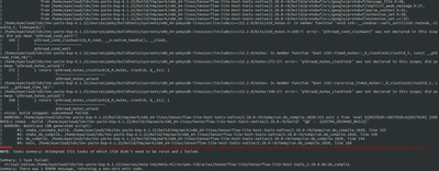

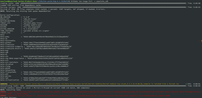

I followed the normal construction steps of yocto and used bitbake imx image full - c population for the first time SDK compilation was successful(My operation steps are based on the attachment), but when I ran this command for the second time, it prompted me that there was an issue with tensorflow-lite-host-tools-native, May I ask how to solve this problem ?

I have tried using bitbake -c cleanall and bitbake -c cleanstate ,bit -c clean, Then use bitbake tensorflow-lite-host-native , But getting the same error message.

Make sure you have installed all host packages in ubuntu, seems relates to pthread library,

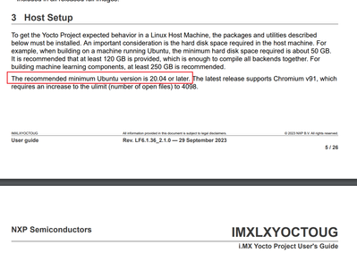

1.The host requirement has written in guide:
2. If you have checked the error , all about pthread library compatible issue.
3.NXP can't control the tensorflow-lite-host-tools-native layer requirement, it needs glibc in Ubuntu20.04+. This is controlled by Google, this software is not maintained by NXP.
4. Each verison ofBSP, we all export SDK. The Ubuntu18.04 has lots of compatible issues when internal test.
5. Please refer the guide, update your Ubuntu version or use docker.

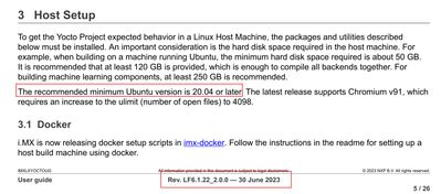

i using REV.LF 6.1.22, Also needed ubuntu 20.04?

I understand now, thank you very much for your help!
