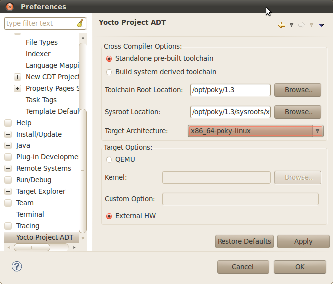

Already install eclipse Yocto plugin and use $bitbake meta-toolchain to create toolchain.
But can't saw ARM platform for iMX28EVK Yocto platform.
Could someone advice a good idea?
Content of local.conf
MACHINE ??= 'imx28evk'
DISTRO ?= 'poky'
PACKAGE_CLASSES ?= "package_rpm"
EXTRA_IMAGE_FEATURES = "debug-tweaks"
USER_CLASSES ?= "buildstats image-mklibs image-prelink"
PATCHRESOLVE = "noop"
CONF_VERSION = "1"
INHERIT += 'rm_work'
BB_NUMBER_THREADS = '2'
PARALLEL_MAKE = '-j 1'
ACCEPT_FSL_EULA = "1"
SDKMACHINE ?= "x86_64"

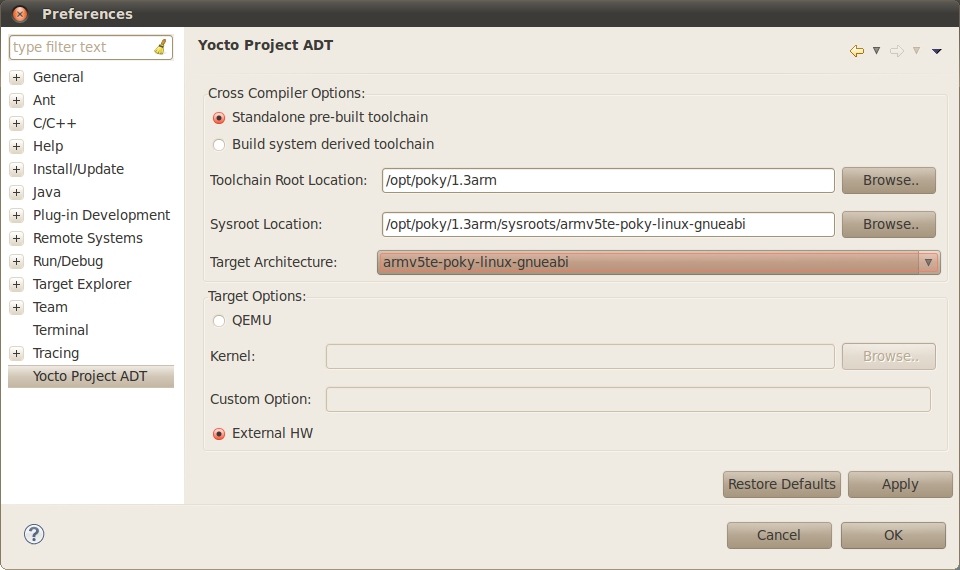

Run script "poky-eglibc-x86_64-arm-toolchain-1.3.sh" on tmp/deploy/sdk
Target Architecture "armv5te-poky-linux-gnueabi" shown. Is it a right setting for iMX28evk?
