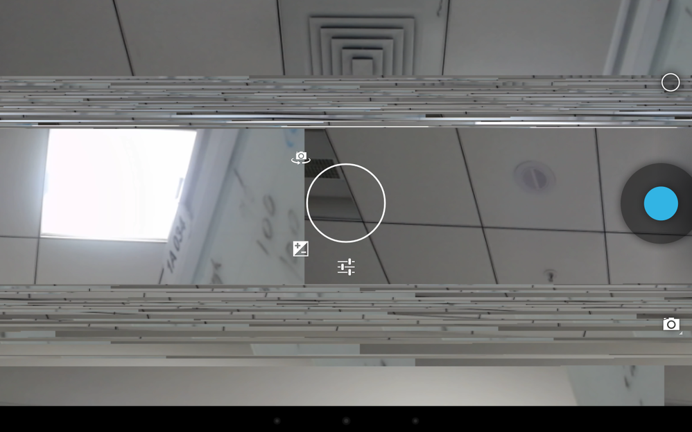

We are seeing Camera preview distortion while USB camera is connected and camera setting dialog is in foreground.
Scenario :
1.       Connect USB camera.
2.       Go to default Google Camera application (GMS) and open USB camera > select camera settings.
3.       Some distortion will be seen on the screen and after few minutes preview frames stops due to timeout issue in Camera HAL at select(mCameraHandle+1, &rfds, NULL, NULL, &tv) in UvcDevice.cpp.
This issue is observed with applications using Surface Texture (OpenGL ES texture) instead of Surface Holder for output destination.
Setup:
Android JB 4.2.2.1.1.0 build
Custom board based on FSL IMX6 Sabresd
Camera: Logitech Webcam C930e and C310
Could you please provide the patches for the above issue for Android 4.2.2?

You can see some improvement by enabling Force GPU rendering.
settings->Developer options-->Force GPU rendering.
Saurabh

Hi Saurabh,
I have enabled Force GPU rendering but still same distortion is seen.
