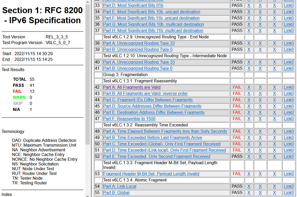

We built a home gateway with i.MX6ULL and Linux 4.14.98 SDK, and it went to mass production stage for years.
Several month ago, we had been notified that we can't get IPv6 certification with TAHI IPv6 conformance test suite. Some test items are failed like this..
I know there are new release SDKs with new kernel version may pass these tests, but it is too hard for us to replace current stable kernel during production stage.
I am wondering is there anyone pass these tests and get TAHI IPv6 certification with Linux 4.14.98? Can it be done by patching kernel IPv6 source code?
=> We haven't tried the TAHI certification test on our end. As NXP is not supporting the TAHI certification.
=> There is no patch available for the TAHI certification test. My apology for the inconvenience.
