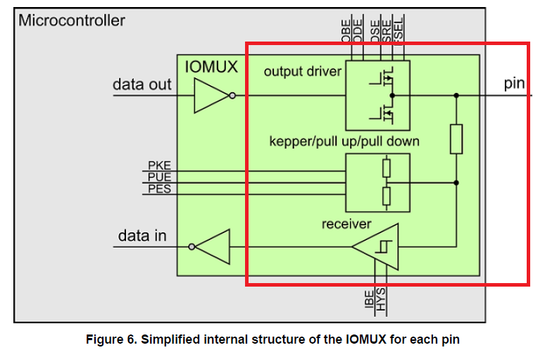

t-iishii
Hi igor
I think that pull-up register in IOMUX is work only between IOMUX and CSI0_DAT5 pin.
Because it have a output driver between AUD3_TXD and pull-up register.
Please see App note: Influence of Pin Setting on System Function and Performance(AN5078.pdf)
To output SSI_STXD from CSI0_DAT5 pin, it have two IP(AUDMUX and IOMUX) three module (AUD1, AUD3 and IOMUX).
   SSI                                   AUDMUX (Normal mode)                    IOMUX
| SSI1 |-STXD->-AUD1_TXD->| AUD1 |->Port1 TXD -> Port3 TxD->| AUD3 |->AUD3_TXD->|-|>--|->DSI0_DAT5
In Section 61.8.7 of Reference manual, if SSI_SCR[TE] = 0, transmission data stops after current frame,
How to state STXD -> AUD1_TXD signal?
If it is floating state, Port1 TXD, after AUD1 signal will go to meta-stable, I think.
Ishii.

igorpadykov
Hi Ishii
seems there is no way for that and you are right about meta-stable,
please check for example Figure 16-9 AUDMUX Chapter 16 i.MX6DQ RM
igor

4,397件の閲覧回数
t-iishii
Hi Igor
Thank you for your response.
Our customer has a noise problem.
While audio data are stopping, some noise are ride on the data line.
So, if data line will go to high-impedance after data transmit internally,
this signal is very week and will picked up a noise by nearside data line or external noise.
In section 61.8.7,  figure61-25 and 61-26 can show that FS, CLK and Data lien go to hi-z,
But sentence is not say about electrical signal status,(only "stop driving these signals").
We hope to know that electrical signal status of "stop driving" state.
Is it Hi-z? or week pull to Hi/Low?
If Hi-z, please teach me a setting of AUDMUX  or IOMUX to pull it.
Ishii.

igorpadykov
Hi Ishii
pull can be configured using IOMUXC_SW_PAD_CTL_PAD_x_y
registers described in IOMUXC Chapter of i.MX6DQ RM
