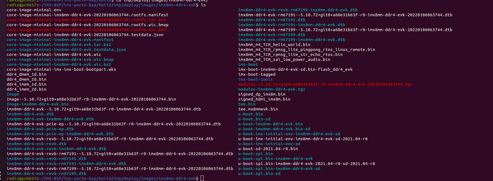

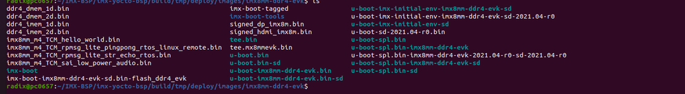

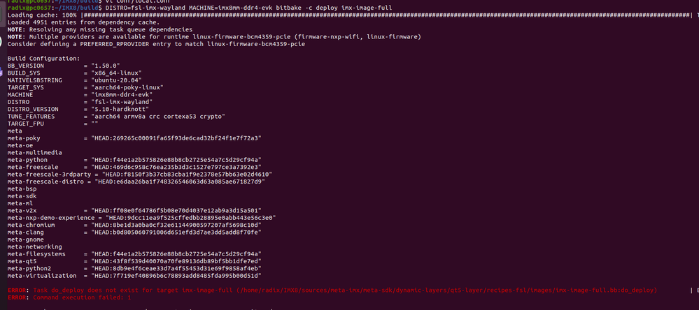

Nirjul_Patel
I Want to File System .sdcard or .wic
I Was Use Command
$DISTRO=fsl-imx-wayland MACHINE=imx8mm-ddr4-evk bitbake -c deploy core-image-minimal
Screenshot from 2022-01-06 10-19-56.pngScreenshot from 2022-01-06 10-19-56.png
ERROR: Task do_deploy does not exist for target core-image-minimal (/home/radix/IMX8/sources/poky/meta/recipes-core/images/core-image-minimal.bb:do_deploy) | ETA: 0:00:01
ERROR: Command execution failed: 1
How Fixed it???

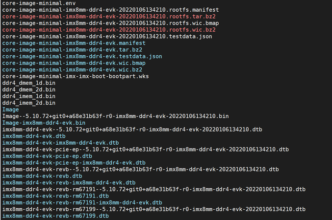

Nirjul_Patel
I Follow The Process As You Say, However I Did Not Get .sdcard or .wic Image File
$ mkdir ~/bin (this step may not be needed if the bin folder already exists)
$ curl https://storage.googleapis.com/git-repo-downloads/repo > ~/bin/repo
$ chmod a+x ~/bin/repo
export PATH=~/bin:$PATH
$ mkdir imx-yocto-bsp
$ cd imx-yocto-bsp
$ repo init -u https://source.codeaurora.org/external/imx/imx-manifest -b b imx-linux-hardknott -m imx-5.10.72-2.2.0.xml
$ repo sync
$ DISTRO=fsl-imx-wayland MACHINE=imx8mm-ddr4-evk source imx-setup-release.sh -b <build dir>
$bitbake core-image-minimal
Image File List
Screenshot from 2022-01-06 17-48-09.pngScreenshot from 2022-01-06 17-48-09.png
And I Want A .sdcard or .wic Image File, So What I Do Now???
8,660 Views
joanxie
did you build successfully and completely? I built just now for you, see parts of images list, you can find wic images:
8,655 Views
Nirjul_Patel
Yes, I Got The Image.

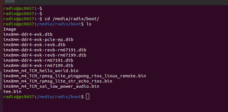

But I Want To Boot The Board From SD card
Screenshot from 2022-01-07 09-00-24.pngScreenshot from 2022-01-07 09-00-24.png
I do this try
$bunzip2 -dk core-image-minimal-imx8mm-ddr4-evk.wic.bz2
$sudo dd if core-image-minimal-imx8mm-ddr4-evk.wic of =/dev/sdb bs=1M conv=fsync
Then Automatically Create two Partition in sdcard 1.boot and 2.root
boot partition list:-
Screenshot from 2022-01-07 09-02-27.pngScreenshot from 2022-01-07 09-02-27.png
root partition:-
Screenshot from 2022-01-07 09-02-51.pngScreenshot from 2022-01-07 09-02-51.png
Evan Then The Board Does Not Boot, Why ??

ok, But I Use This Command Then I will Get .sdcard Or .wic Image File ?
8,678 Views
joanxie
yes, you can find them in the folder <build folder>/tmp/deploy/images

joanxie
how about try this:
$DISTRO=fsl-imx-wayland MACHINE=imx8mm-ddr4-evk bitbake  core-image-minimal
