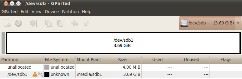

I have tried this with the gparted and am attaching an image,
I want to use and place my u-boot.bin and uImage in the locations you have specified, for that I gave partition 1, a size of 4 MB, using sudo fdisk /dev/sdb the sequence next being  u d n p 1 8192 Enter w   against command(m for help):    prompt.
612-gpart_daiane.pngI ran the steps according to linux-3DStack guide and copied all the supporting files to SD Card, But, there is no boot because the 4MB has to be filled with the u-boot.bin & uImage which in my case has not happened.
Regards::: Krishna Pavan

your SDCard MBR looks like being corrupted.
If you´re getting trouble using fdisk (I absolutly get confused with it), please use gparted (I use this because I don´t like to count blocks)
Take a look here http://imxcommunity.org/xn/detail/4103961:Comment:23615 to see how I use gparted.
First of all, create the MBR again. So, create any partition you want.
And don´t forget SDCard is (for linux booting):
first 512 -> MBR
at 1K -> bootloarder
at 1M -> uImage

Looks like it is in use somehow. So unmount it first before running fdisk on it:
sudo umount /dev/sdb*
