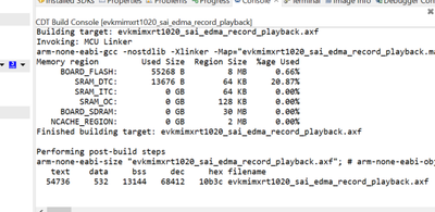

I want to use SDRAM to run SAI, but it doesn't seem to work properly after modifying the memory configuration. What is the reason?
I'm using the evkmimxrt1020_sai_edma_record_playback in SDK, And adjust RAM to point to BOARD_SDRAM. The program doesn't seem to be working properly.

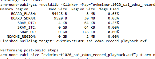

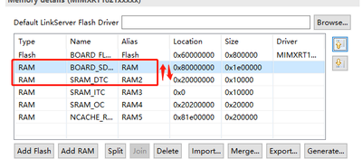

First of all, thank you for your reply. I can't find relevant information in the answer you provided.
In fact, in my project, it is already linked to SDRAM running, but after adding SAI related tasks, the task of reading and writing data in TDM will block.
So, I tried to change sai_edma_record_playback to run SDRAM as well and found that the program was blocking while reading and writing data.

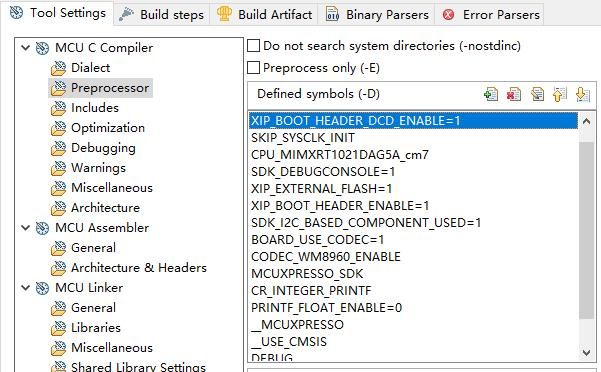

I checked the code, I find this project didn't enable the DCD which is used to configure the SDRAM, do you enable it?
If you didn't init the SEMC, then after you up the SDRAM memory, it may meet issues, or you can add the .scp with the SEMC init code if you are using the CMSIS DAP debugger.
Anyway, from your description, the issue should be related to the SDRAM is not init in the SDK project.

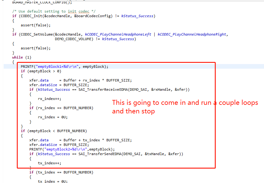

Thank you for your reply.The version of SDK I use is SDK_2_11_0_EVK-MIMXRT1020.
If it is the default configuration in demo, I did not stop at CODEC_Init and the program will run normally.
If I switch to SDRAM and I add the macro definition of DCD, the program will stop in the loop of sending and receiving data, but will run several loops.
