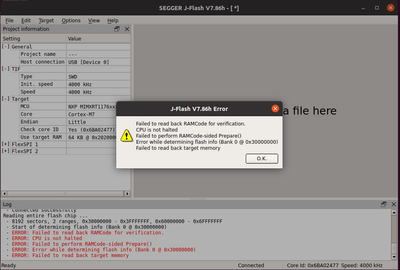

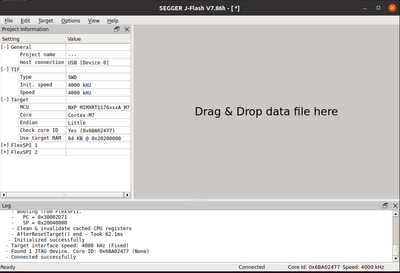

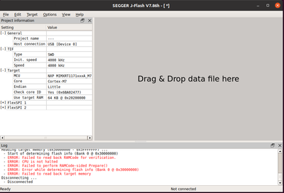

Cannot read from or write into the MCU flash memory using Segger J-Flash tool (Using the J-Link Plus tool).
Successfully can connect to MCU.
Reading form flash memory has not happening and the error message is shown below.
Need your support in fixing this problem

kerryzhou
Hi @Jayasankar ,
  Please tell me which RT1176 board you are using? The NXP MIMXRT1170-EVK ?
  In fact, we need to know what's the external flash you are using, this will determine you can success with JLINK or not, your issue is caused by you use the wrong flashdriver in the JLINK.
  Take an example, you need to use octal flash, but you use the qspi flash driver, then it will be failed.
  So, please let me know your board situation and flash.

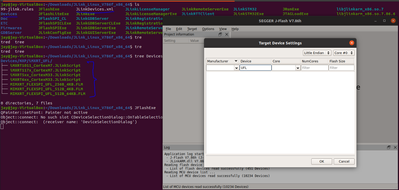

Jayasankar
Hello @kerryzhou
The target device is not visible after copying the Device and JLinkDevice.xml fie into JFlash directory. Is there something to run before starting JFlashExe command. So that the newly copied devices would relect in the JFlash window.

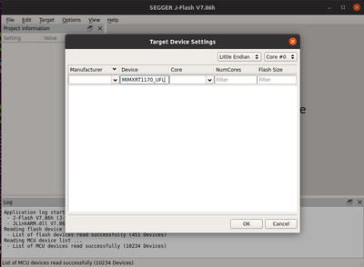

Jayasankar
Hello Kerry,
I cannot find the target and shared the screenshot below.
I tried with multiple version of JFlash like V786f, V786h and V767d. But the newly copied devices are not showing in JFlashExe. Could you please share your Jflash package if possible.

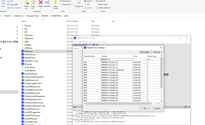

kerryzhou
Hi @Jayasankar ,
   I download the newest Segger driver:
https://www.segger.com/downloads/jlink/JLink_Windows_V788a_x86_64.exe
After install it, then I add my related code:
Unzip my attached file, you will get:
You can copy it to the JLINK install path:
C:\Program Files\SEGGER\JLINKV788A\JLink
You can find, I can find the related RT117X
Please try it again.
Wish it helps you!

Jayasankar
Hi @kerryzhou
As you could see in above pictures, I am working with Linux host machine. Hope it should work in Linux as well. Can you please confirm once.
3,310 次查看
kerryzhou
Hi @Jayasankar ,
  In your linux version, do you also do my related configuration or not?
  If yes, I think you need to check with Segger side, it means the Segger software Linux version have issues, and our NXP also can't do the modification, you can check with Segger side:
https://www.segger.com/support/technical-support/
kerry
