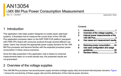

Hi @karthicknarayanan
Please refer the AN13054 i.MX 8M Plus Power Consumption Measurement.
Will reducing CPU frequency or DDR frequency or disabling CPU core results in similar observation which I have mentioned above with compromise on performance ?
-->Of course,
And using VPU instead of using CPU to capture frames will result in better performance and power consumption ?
-->VPU is used for decode or encode, not read frame.
