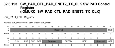

I have a question about ENET1_TX_CLK & ENET2_TX_CLK control registers.
I see that in most cases, it uses a 0x400XXXXX value. Here an example:
imx6ul-14x14-evk.dtsi: MX6UL_PAD_ENET1_TX_CLK__ENET1_REF_CLK1 0x4001b031
imx6ul-14x14-evk.dtsi: MX6UL_PAD_ENET2_TX_CLK__ENET2_REF_CLK2 0x4001b031
But what 30-bit means?
Documentation doesn't define 30-bit:
