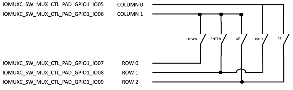

We have a matrix keypad on iMX8M that behaves unexpectedly.
When pressing the "ENTER" button, an event for two keys are sent on key down but only sometimes. Single event is sent on key up.

The electrical schematics is as follows:
We are using the driver matrix_keypad.c on Linux 6.1.1, this is our device tree:

How would you recommend we set the pin muxing and pin control to have only single events from any key up and key down press on any button?
Do you have any other solution to propose?

NamnNamnsson
Hi Mr. Vasavada,
I hope you are doing well also. The HW design is the same as when we used an iMX6 so we would expect it to work on iMX8 in a similar fashion.
Your Toradex link was not really helpful as we have succesfully bound the driver in the device tree and do get the key presses in user space, as per my explanation above.
What you could do to help is to specifically recommend the pinmux settings for PU/PD in the pinmux registers.
