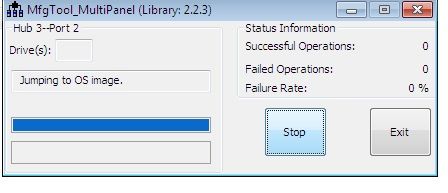

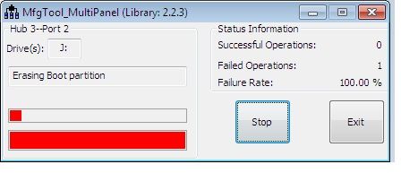

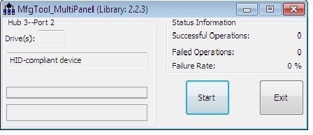

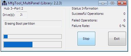

Hi all,
I am using mx6 solo processor with 512mb ram for our customized board, for that i tried to program the u-boot binary to spi nor flash using MFG TOOL, I configured the two config files cfg and UIcfg as below
can any one plz suggest any idea
CFG FILE:
[profiles]
chip = MX6DL Linux Update
[platform]
board = SabreARD
[LIST]
name = MX6SOLO-Sabreauto-SPI_NOR & SD card
UIcfg FILE
[UICfg]
PortMgrDlg=1
It stops in the Erasing rootfs partition, is i missing any thing or i configured anything wrong, i aatched the MFG log file and screen shot of the error
ERROR:
10445_10445.jpgmfg1.jpg10446_10446.jpgmfg2.jpg10447_10447.jpgmfg4.jpg10448_10448.jpgmfg3.jpg
MFG TOOL LOG FILE:
Original Attachment has been moved to: MfgTool.log.zip

alejandrolozan1
If you boot from the SD card are you able to write and read to the SPI NOR?
Did you modify the ycl2.xml too?
Alejandro
