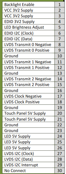

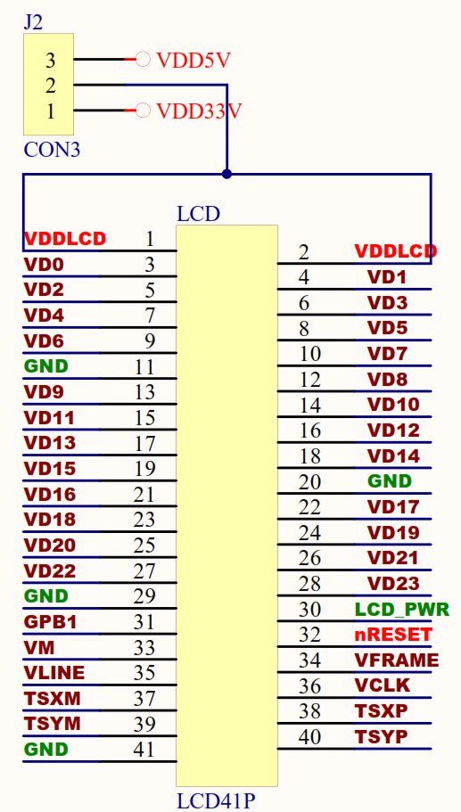

I intend to buy the i.MX53 QSB and already own an innolux 7" touchscreen.
Freescale specs announce compatibility with most of the LVDS of the market  but the innolux doesn't seem to be so compatible at all.
Comparing the LCD signals from my mini2440 connector :
with the one in the manual :
- did I got it wrong or the both are incompatible ?
- do I have to buy another one ? my goal is to use it with a Qt application for some knobs and settings no fancy video/picture things
