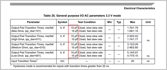

Dear NXP Team,
I am looking for the input capacitance i.MX1062. Especially, I am interested in the EMC pins.
Best wishes.
637 Views
diego_charles
Hi @OliR86
There is no documented input capacitance for the EMC interface pins.
Below table shows Genereal purpose IC AC parameters for 3.3v mode. Where a15 pF where modeled in the test condition.
