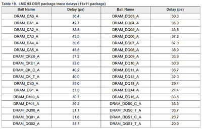

1) Need propagation delay values for the LPDDR4 lines (or all) for 11x11 IMX93 package.   Using Altium for the project.   Required as we prepare to tune the LPDDR4 traces.  Did not see this in the IBIS Model.

1) Please refer to Hardware Design Guide, chapter 3.6.6 i.MX 93 DDR package delays:
