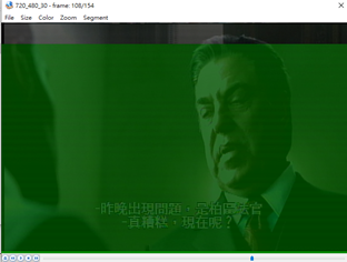

I test waving mode in 720X480,and get below preview
I asked FAE about this question, reply as below
ISL79987 needs to be paired with i.MX8QXP (Rev C0) to work properly. i.MX8QM contains an errata as shown below. Due to this errata, there will be screen problems when using virtual-channel and de-interlace.
iMX8QM needs to modify the settings to workaround with ISL79987 under the following conditions:
The 4 x de-interlace can't work on iMX8QM B0 chip. It can only work on iMX8QXP/DX C0 chips.
For iMX8QM, it can only support 4 x 720*240 @ 60fps with ISL79987 set in field mode. The modification in linux kernel:

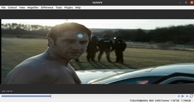

I set field mode and 720X240,the video looks acceptable
