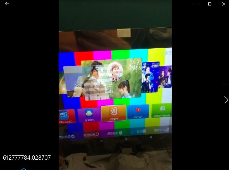

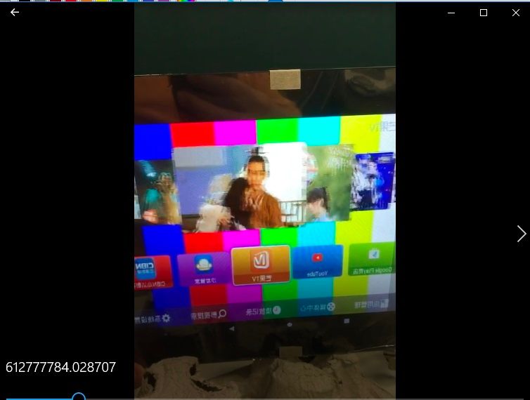

Hello.
Do i.mx8mq support TVin architecture? Now I use adv7282m, Mipi CSI output. I have implemented the driver, but the Hal layer cannot collect data.
The driver architecture is designed according to the driver of isl79987 provided by you!

Question 1 : I port your binary tool mx8_v4l2_cap_drm to our imx8qm android 9 board, and I run as the command of "mx8_v4l2_cap_drm -cam 1 -d "/dev/video1" -fmt YUYV -num 30000 -log 6", which /dev/video1 is our video-in TW9992 MIPI driver, but get error code as below,
(init_video_channel:503): init channel[0] v4l2_dev_name=/dev[ 183.913165] mxc-isi 58140000.isi: mxc_isi_capture_open, ISI4
/video1 w/h=(1280,800)
(open_drm_device:611): Open /dev[ 183.924675] tw9992_s_power#1006: on=1
/dri/card0 success
(open_v4l2_device:644): open /dev/video1 success
command pid dev master a uid magic[ 183.984317] mxc-isi 58140000.isi: mxc_isi_capture_release
composer@2.1-se 3628 0 y y 1000 0
[ 183.998481] tw9992_s_power#1006: on=0
composer@2.1-se 3628 128 n n 1000 0
mx8_v4l2_cap_dr 4909 0 n y 0 0
Please ensure there is no other master client
How can I fix it ?
Question 2: I use "v4l2-ctrl" to dump frame of tw9992, but get incorrect frame captured.
command:
v4l2-ctl -d /dev/video1  --set-standard=pal --set-fmt-video=width=720,height=576,pixelformat=YUYV --stream-mmap=3 --stream-skip=3 --stream-to=/sdcard/tw9992.raw --stream-count=1 --stream-poll
log:
[ 1168.781924] init: couldn't write 5757 to /dev/cpuset/camera-daemon/tasks: No such file or directory
[ 1168.924382] mxc-jpeg 58450000.jpegenc: Descriptor for dec/enc: ffff00000aa3f000 0xae002000
[ 1168.932948] mxc-jpeg 58450000.jpegenc: Descriptor for config phase: ffff00000aa40000 0xae003000
[ 1168.941737] mxc-jpeg 58450000.jpegenc: Configuration stream: ffff00000aa41000 0xae004000
[ 1168.951906] mxc-isi 58140000.isi: mxc_isi_capture_open, ISI4
[ 1168.957915] tw9992_s_power#1006: on=1
[ 1168.961974] mxc-isi 58140000.isi: mxc_isi_capture_release
[ 1168.972424] tw9992_s_power#1006: on=0
[ 1168.976346] mxc-isi 58100000.isi: mxc_isi_m2m_open, ISI0
[ 1168.987185] mxc-isi 58100000.isi: mxc_isi_m2m_release
[ 1168.999270] mxc-jpeg 58400000.jpegdec: Descriptor for dec/enc: ffff00000aa3f000 0xae002000
[ 1169.007593] mxc-jpeg 58400000.jpegdec: Descriptor for config phase: ffff00000aa40000 0xae003000
[ 1169.016352] mxc-jpeg 58400000.jpegdec: Configuration stream: ffff00000aa41000 0xae004000
[ 1169.032970] init: Service 'vendor.camera-provider-2-4' (pid 5757) exited with status 1
[ 1169.041114] init: Sending signal 9 to service 'vendor.camera-provider-2-4' (pid 5757) process group...
[ 1169.050649] audit: audit_lost=17678 audit_rate_limit=5 audit_backlog_limit=64
[ 1169.057950] audit: rate limit exceeded
[ 1169.061876] libprocessgroup: Successfully killed process cgroup uid 1047 pid 5757 in 11ms
[ 1169.146907] mxc-isi 58140000.isi: mxc_isi_capture_open, ISI4
[ 1169.152893] tw9992_s_power#1006: on=1
[ 1169.157024] mxc-isi 58140000.isi: mxc_isi_cap_s_std
[ 1169.161963] mxc-mipi-csi2 58247000.csi: mipi_csi2_s_std
[ 1169.167254] tw9992_s_std#827: 0 others
Standard set to 000000ff[ 1169.171157] mxc-isi 58140000.isi: mxc_isi_cap_g_fmt_mplane
[ 1169.178831] mxc-isi 58140000.isi: mxc_isi_cap_s_fmt_mplane, fmt=0x56595559
[ 1169.187645] mxc-isi 58140000.isi: cap_vb2_queue_setup, buf_n=3, size=829440
[ 1169.203720] mxc-isi 58140000.isi: cap_vb2_buffer_prepare
[ 1169.209133] mxc-isi 58140000.isi: cap_vb2_buffer_prepare
[ 1169.214559] mxc-isi 58140000.isi: cap_vb2_buffer_prepare
[ 1169.219940] mxc-isi 58140000.isi: mxc_isi_cap_g_fmt_mplane
[ 1169.225487] mxc-isi 58140000.isi: mxc_isi_cap_streamon
[ 1169.230667] tw9992_set_fmt#905: mbusformat=0x1, pixelformat=0x50424752
[ 1169.237261] tw9992_get_fmt#968
[ 1169.240434] tw9992_mipi 7-0044: tw9992_get_fmt code=0x1017, w/h=(720,576), colorspace=7, field=0
[ 1169.249268] mxc-mipi-csi2 58247000.csi: width=720, height=576, fmt.code=0x1017
[ 1169.261526] input fmt RGB4
[ 1169.264255] output fmt YUYV
[ 1169.267092] mxc-isi 58140000.isi: mxc_isi_channel_set_scaling: no scale
[ 1169.273745] mxc-isi 58140000.isi: cap_vb2_start_streaming
[ 1169.282040] mxc-isi 58140000.isi: cap_vb2_start_streaming: num_plane=0 discard_size=829440 discard_buffer=ffff00002c8c5000
[ 1169.557859] mxc-isi 58140000.isi: ISI CHNLC register dump, isi4
[ 1169.563808] mxc-isi 58140000.isi: CHNL_CTRL 0x0h = 0xc0ff0003
[ 1169.571010] mxc-isi 58140000.isi: CHNL_IMG_CTRL 0x4h = 0x20000006
[ 1169.578007] mxc-isi 58140000.isi: CHNL_OUT_BUF_CTRL 0x8h = 0x c000
[ 1169.585182] mxc-isi 58140000.isi: CHNL_IMG_CFG 0xCh = 0x 24002d0
[ 1169.592182] mxc-isi 58140000.isi: CHNL_IER 0x10h = 0x3dff0000
[ 1169.599220] mxc-isi 58140000.isi: CHNL_STS 0x14h = 0x 200
[ 1169.606217] mxc-isi 58140000.isi: CHNL_SCALE_FACTOR 0x18h = 0x10001000
[ 1169.613239] mxc-isi 58140000.isi: CHNL_SCALE_OFFSET 0x1Ch = 0x 0
[ 1169.620245] mxc-isi 58140000.isi: CHNL_CROP_ULC 0x20h = 0x 0
[ 1169.627253] mxc-isi 58140000.isi: CHNL_CROP_LRC 0x24h = 0x 0
[ 1169.634243] mxc-isi 58140000.isi: CHNL_CSC_COEFF0 0x28h = 0x 810041
[ 1169.641258] mxc-isi 58140000.isi: CHNL_CSC_COEFF1 0x2Ch = 0x 7db0019
[ 1169.648259] mxc-isi 58140000.isi: CHNL_CSC_COEFF2 0x30h = 0x 7007b6
[ 1169.655266] mxc-isi 58140000.isi: CHNL_CSC_COEFF3 0x34h = 0x 7a20070
[ 1169.662262] mxc-isi 58140000.isi: CHNL_CSC_COEFF4 0x38h = 0x 1007ee
[ 1169.669274] mxc-isi 58140000.isi: CHNL_CSC_COEFF5 0x3Ch = 0x 800080
[ 1169.676265] mxc-isi 58140000.isi: CHNL_ROI_0_ALPHA 0x40h = 0x 0
[ 1169.683274] mxc-isi 58140000.isi: CHNL_ROI_0_ULC 0x44h = 0x 0
[ 1169.690264] mxc-isi 58140000.isi: CHNL_ROI_0_LRC 0x48h = 0x 0
[ 1169.697275] mxc-isi 58140000.isi: CHNL_ROI_1_ALPHA 0x4Ch = 0x 0
[ 1169.704275] mxc-isi 58140000.isi: CHNL_ROI_1_ULC 0x50h = 0x 0
[ 1169.711286] mxc-isi 58140000.isi: CHNL_ROI_1_LRC 0x54h = 0x 0
[ 1169.718276] mxc-isi 58140000.isi: CHNL_ROI_2_ALPHA 0x58h = 0x 0
[ 1169.725286] mxc-isi 58140000.isi: CHNL_ROI_2_ULC 0x5Ch = 0x 0
[ 1169.732294] mxc-isi 58140000.isi: CHNL_ROI_2_LRC 0x60h = 0x 0
[ 1169.739304] mxc-isi 58140000.isi: CHNL_ROI_3_ALPHA 0x64h = 0x 0
[ 1169.746294] mxc-isi 58140000.isi: CHNL_ROI_3_ULC 0x68h = 0x 0
[ 1169.753308] mxc-isi 58140000.isi: CHNL_ROI_3_LRC 0x6Ch = 0x 0
[ 1169.760310] mxc-isi 58140000.isi: CHNL_OUT_BUF1_ADDR_Y 0x70h = 0xbfa00000
[ 1169.767317] mxc-isi 58140000.isi: CHNL_OUT_BUF1_ADDR_U 0x74h = 0x 0
[ 1169.774304] mxc-isi 58140000.isi: CHNL_OUT_BUF1_ADDR_V 0x78h = 0x 0
[ 1169.781315] mxc-isi 58140000.isi: CHNL_OUT_BUF_PITCH 0x7Ch = 0x 5a0
[ 1169.788308] mxc-isi 58140000.isi: CHNL_IN_BUF_ADDR 0x80h = 0x 0
[ 1169.795316] mxc-isi 58140000.isi: CHNL_IN_BUF_PITCH 0x84h = 0x 0
[ 1169.802306] mxc-isi 58140000.isi: CHNL_MEM_RD_CTRL 0x88h = 0x 0
[ 1169.809317] mxc-isi 58140000.isi: CHNL_OUT_BUF2_ADDR_Y 0x8Ch = 0xbf700000
[ 1169.816317] mxc-isi 58140000.isi: CHNL_OUT_BUF2_ADDR_U 0x90h = 0x 0
[ 1169.823329] mxc-isi 58140000.isi: CHNL_OUT_BUF2_ADDR_V 0x94h = 0x 0
[ 1169.830325] tw9992_s_stream#990: enable=1
[ 1169.834376] tw9992_start_mipi#589
[ 1169.838458] tw9992_check_stable_decoder use 00ms
[ 1169.870957] mxc-mipi-csi2 58247000.csi: mipi_csi2_s_stream: 1, csi2dev: 0x0
[ 1169.877993] tw9992_get_fmt#968
[ 1169.881056] tw9992_mipi 7-0044: tw9992_get_fmt code=0x1017, w/h=(720,576), colorspace=7, field=0
[ 1169.890324] mxc-mipi-csi2 58247000.csi: width=720, height=576, fmt.code=0x1017
[ 1169.897718] mxc-isi 58140000.isi: mxc_isi_pipeline_enable ,entity is no v4l2, mxc_isi.4.capture
[ 1169.933009] mxc-isi 58140000.isi: cap_vb2_buffer_prepare
<[ 1169.953905] mxc-isi 58140000.isi: cap_vb2_buffer_prepare
<[ 1169.972868] mxc-isi 58140000.isi: cap_vb2_buffer_prepare
<[ 1170.010709] mxc-isi 58140000.isi: cap_vb2_buffer_prepare
<[ 1170.016104] mxc-isi 58140000.isi: mxc_isi_cap_streamoff
[ 1170.021730] tw9992_s_stream#990: enable=0
[ 1170.025774] tw9992_stop_mipi#578
[ 1170.030666] mxc-mipi-csi2 58247000.csi: mipi_csi2_s_stream: 0, csi2dev: 0x0
[ 1170.037735] mxc-isi 58140000.isi: mxc_isi_pipeline_enable ,entity is no v4l2, mxc_isi.4.capture
[ 1170.046954] mxc-isi 58140000.isi: cap_vb2_stop_streaming
[ 1170.052784] mxc-isi 58140000.isi: mxc_isi_capture_release
[ 1170.064182] tw9992_s_power#1006: on=0
frame captured:

Hi Qiang Li
Thanks for your advice, it's helpful
The TV function works , but I get a new issue
There is interlace section When switch TV page like below photo
I set weaving mode de-interlace in CHNL_IMG_CTRL_DEINT_WEAVE_ODD_EVEN
Should I change to  blending mode ?
Can you provide some suggestions ?
Hi Qiang Li
I intergrate blending mode on ISI4 to support tw9992
But it doesn't work to display
This is my isi4 register dump log
How can I fix it ?
