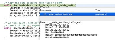

I’ve shifted my focus to the memory setup of the XIP application.   Since we have no external RAM I've placed the stack and heap in SRAM_DTC.  Yet we still seem to jump to address 0 after the SystemInit() returns.   If I comment out SystemInitHook() the code executes farther until the data_load but eventually stops there.  Wondering if there is some FlexRAM requirement missing?
I read a DCD initialization for SDRAM is required for for Debugging.  When I trace the code I see SDRAM (0x80000000) in the memory setup before my program main.  Is this expected?

mrecoskie
I got this to work by moving the SDRAM and NCACHE memory definitions to the end of the list.  Strangely removing these lines did not work.
Screen Shot 2023-01-17 at 10.47.18 AM.pngScreen Shot 2023-01-17 at 10.47.18 AM.png
Can anyone provide an explanation as to why this was the solution?

jingpan
Hi @mrecoskie ,
If you put SDRAM behind ITCM/DTCM, compiler will put .data/.bss segment into SDRAM. When debugging, IDE will also access SDRAM. But the SDRAM is not initialized at this time. You need a script to initialize SDRAM first.
