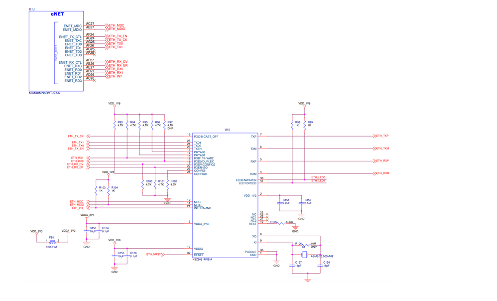

In our custom board based on IMX8MN, we are facing issue in RMII Ethernet interface.
Below is the device tree configuration.

After booting, we are able to see Ethernet driver log
[ 6.069688] Micrel KSZ8081 or KSZ8091 30be0000.ethernet-1:00: attached PHY driver [Micrel KSZ8081 or KSZ8091] (mii_bus:phy_addr=30be0000.ethernet-1:00, irq=77)
But when we connect Ethernet cable to the board, the link is not getting detected. I found one reference dts imx8mq-ddr3l-val.dts, where a RMII interface has been configured.

In the above pin mux configuration it uses MX8MQ_IOMUXC_ENET_TD2_ENET1_TX_CLK, but we are using MX8MN_IOMUXC_ENET_TXC_ENET1_RGMII_TXC.
Whether ENET1_TX_CLK and ENET1_RGMII_TXC are same..?
 Will it cause a problem in link detection
Below is our custom board RMII ethernet connection schematic.
Ethernet RMII schematicEthernet RMII schematic

igorpadykov
Hi love1ymano
rmii clocks are described in Table 11-78. ENET External Signals
i.MX 8M Nano Applications Processor Reference Manual
ENET1_TX_CLK - Used as RMII clock - pad ENET_TD2 (ALT1)
sect.8.2.5.22 Pad Mux Register (IOMUXC_SW_MUX_CTL_PAD_ENET_TD2)
igor
