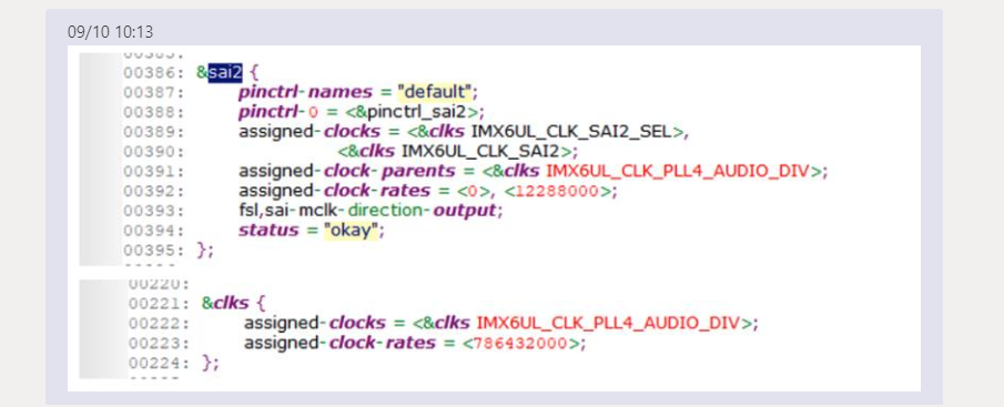

Hello all,
i need to configure the IMX pin that control the LRCLK pin of the MAX98090 as outpout beacuse i have problem with the clock signal levels. For the MCLK we have do that in this way:
how can i do the same for the LRCLK pin that is connected to the SAI_SYNC pin?

dc1
thanks we are trying to understand if the configuration of the pins is correct for our MAX98090 that is different from the wm8960 . We have set the fsl,pins in this way:
 pinctrl_sai2: sai2grp {
                        fsl,pins = <
                                MX6UL_PAD_JTAG_TDI__SAI2_TX_BCLK        0x170A1
                                MX6UL_PAD_JTAG_TDO__SAI2_TX_SYNC        0x170A1
                                MX6UL_PAD_JTAG_TRST_B__SAI2_TX_DATA     0x110A0
                                MX6UL_PAD_JTAG_TCK__SAI2_RX_DATA        0x110A0
                                MX6UL_PAD_JTAG_TMS__SAI2_MCLK           0x170A1
 reducing the DSE resistence and enabling the fast slew rate
we have seen that the PAD define are:
 * The pin function ID is a tuple of
 *                                                                                                 <mux_reg conf_reg input_reg mux_mode input_val>
#define MX6UL_PAD_SD1_CLK__SAI2_MCLK                          0x01C0   0x044C   0x05F0   0x2         0x1
#define MX6UL_PAD_SD1_DATA0__SAI2_TX_SYNC               0x01C4   0x0450   0x05FC   0x2         0x1
#define MX6UL_PAD_SD1_DATA1__SAI2_TX_BCLK               0x01C8    0x0454   0x05F8   0x2         0x1
#define MX6UL_PAD_SD1_DATA2__SAI2_RX_DATA                0x01CC   0x0458   0x05F4   0x2         0x1
#define MX6UL_PAD_SD1_DATA3__SAI2_TX_DATA                0x01D0   0x045C   0x0000   0x2          0x0
with the value written in the fsl,pins (for example the 0x170A1) we are going to over-write a value of the #define here upper or what?
