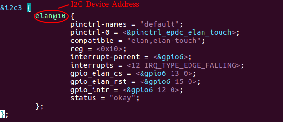

I'd like to know I2C address of following devices that is used with i.MX 7DUAL SABRE BOARD.
  1)LCD8000-43T
  2)EPD controller
Which document should I read, or how can I get to those information?

One can get the I2C address of the mentioned devices i.e. LCD8000-43T and EPD controller from their respective datasheets. The datasheets would be available from the vendor of the respective devices.
Also, we can get the I2C address of the device from the DTS node of i.MX7D board.
In, i.MX7D SABRE SD board I2C lines of LCD8000-43T device are not being used which is also mentioned in schematic.However, for EPD controller device, I2C3 bus is used with 0x10 as device address. Device tree node for the same is specified in arch/arm/boot/dts/imx7d-sdb-epdc.dtsi" file which is shown in below screenshot.

thattor1
Dear Radhika,
Thank you for your reply and helpful information.
It's good to me.
I'm considering using another device with connecting to I2C3 bus on SABRE BOARD.
Now I could find that there is no conflict of I2C addresses of each devices.
Thank you for your cooperation.
HATTORI, Tsutomu

    Thanks for the updates. You can also use i2c device detection utility in linux to find the I2C address of connected device.
