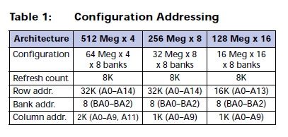

Hi Jean,
Please check whether COLUMN_SIZE ADDR_PINS of HW_DRAM_CTL29 are set correctly.
Grace

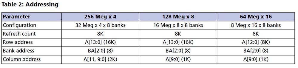

Hi Jean,
The addressing table I showed in last comment doesn't apply to your MT47H128M16.  It is from the datasheet of Micron 1GB DDR2.
You should check the datasheet of MT47H128M16 to get correct addressing.
MT47H128M16 – 16 Meg x 16 x 8 banks
So ADDR_PINS should be 1 and COLUMN_SIZE should be 2.
Grace

  I use in my project the DDR2 SDRAM MT47H128M16 – 16 Meg x 16 x 8 banks.
Row address A[13:0] (16K), actual number of address pins = 14.
Column address A[9:0] (1K), actual number of column pins = 10.
So in the DRAM Control Register 29 (HW_DRAM_CTL29) should be:
  the field 10...8 (ADDR_PINS) = 15-14 = 1.
  the field 18...16(COLUMN_SIZE) = 12-10 = 2.
  other fields are unchanged (as in i.MX28 Evk project).
As the result I should write the value 0x0F02010A into the HW_DRAM_CTL29.
