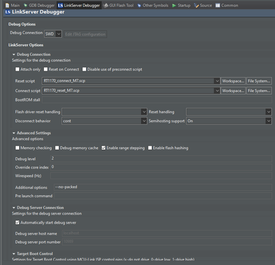

I'm coming back with a solution to my problem.
The culprit was the whole time (or so I choose to believe) in the debug session configuration itself!!
Take a look at the image below.
Do note that upon creation of a new debug configuration instance for Link Server, the RESET HANDLING method is not set to anything, it is just a blank field. One must explicitly choose one of the available methods from the drop down window.
I do not know whether it was intentional in order for some compliancy matters or some sort of safety precaution, but for me it seems like something not obvious at first. Why it could not be set to default value as in the previous image?
Anyway, I'm glad to have that thing sorted, now is time to take on next problems and challenges

16: Target error from status-poll: Nn(05). Wire ACK Fault in DAP access
From the above I think that the process of writing the data completes without any issues, but the process of trying to start the code is where the process fails.
After the process fails I get the following:
or
I suspect that it's the issue of Program Counter (PC) being set to some garbage value but I'm no expert here.
PS:
Sorry for the long post but I tried to give as much info for the context as I could.
