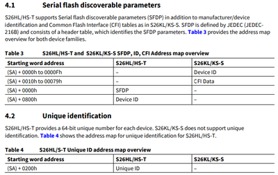

3.) I started to go through the ufl source code and noticed that it may not work out of the box for my case, because there are subtle differences between the hyperflash that was tested for the current UFL 1.0 release and the newer ones that are available.
So it seems like CFI is no longer there and the coded procedure will not work properly for that chip.
However, I can also modify the code "hard code" the proper values that are required here and there.
Additionally, default page size is not 512B but 256B, which can also be easily changed in the code to correspond with the proper setting of hyperflash memory. That part I need to test out tomorrow, because I do not have access to the hardware right now.

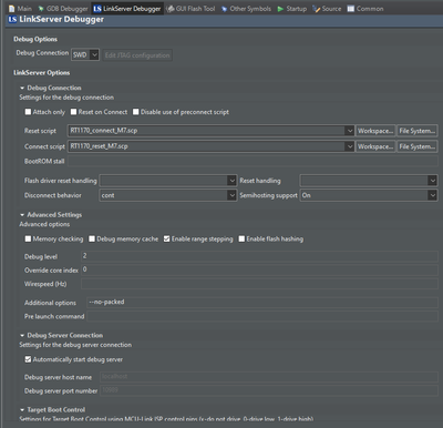

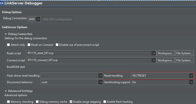

I'm coming back with a solution to my problem.
The culprit was the whole time (or so I choose to believe) in the debug session configuration itself!!
Take a look at the image below.

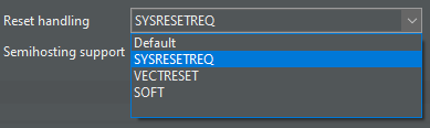

Do note that upon creation of a new debug configuration instance for Link Server, the RESET HANDLING method is not set to anything, it is just a blank field. One must explicitly choose one of the available methods from the drop down window.
I do not know whether it was intentional in order for some compliancy matters or some sort of safety precaution, but for me it seems like something not obvious at first. Why it could not be set to default value as in the previous image?
Anyway, I'm glad to have that thing sorted, now is time to take on next problems and challenges

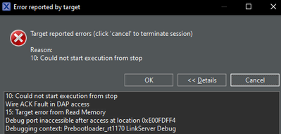

I get the following error:
ChecksumSectors (0x30000000, 0x2000F668, 0x1) status 0x3 - driver reported driver error - EXTSPIJ driver
No matter which FlashDeviceV_t device type I use (EXTSPI, EXTSPIJ, UNKNOWN) I get the same result.
It is worth to note that after that error, writing firmware bytes is processing until the end, after being complete, mem fault happen and the code wild (probably because of the incorrect SP value).

16: Target error from status-poll: Nn(05). Wire ACK Fault in DAP access
From the above I think that the process of writing the data completes without any issues, but the process of trying to start the code is where the process fails.
After the process fails I get the following:
or
I suspect that it's the issue of Program Counter (PC) being set to some garbage value but I'm no expert here.

Hello @mimlo,
Just for double check, could you please take a look at the Hyper Flash specifications in the MIMXRT1170 EVK Board Hardware User’s Guide. Section 2.6 Hyper Flash? There it is mentioned a setting that must be followed to enable the OCT Flash. Also, could you please take a look to Section 2.2 Boot mode configurations?
Best regards, Raul.
